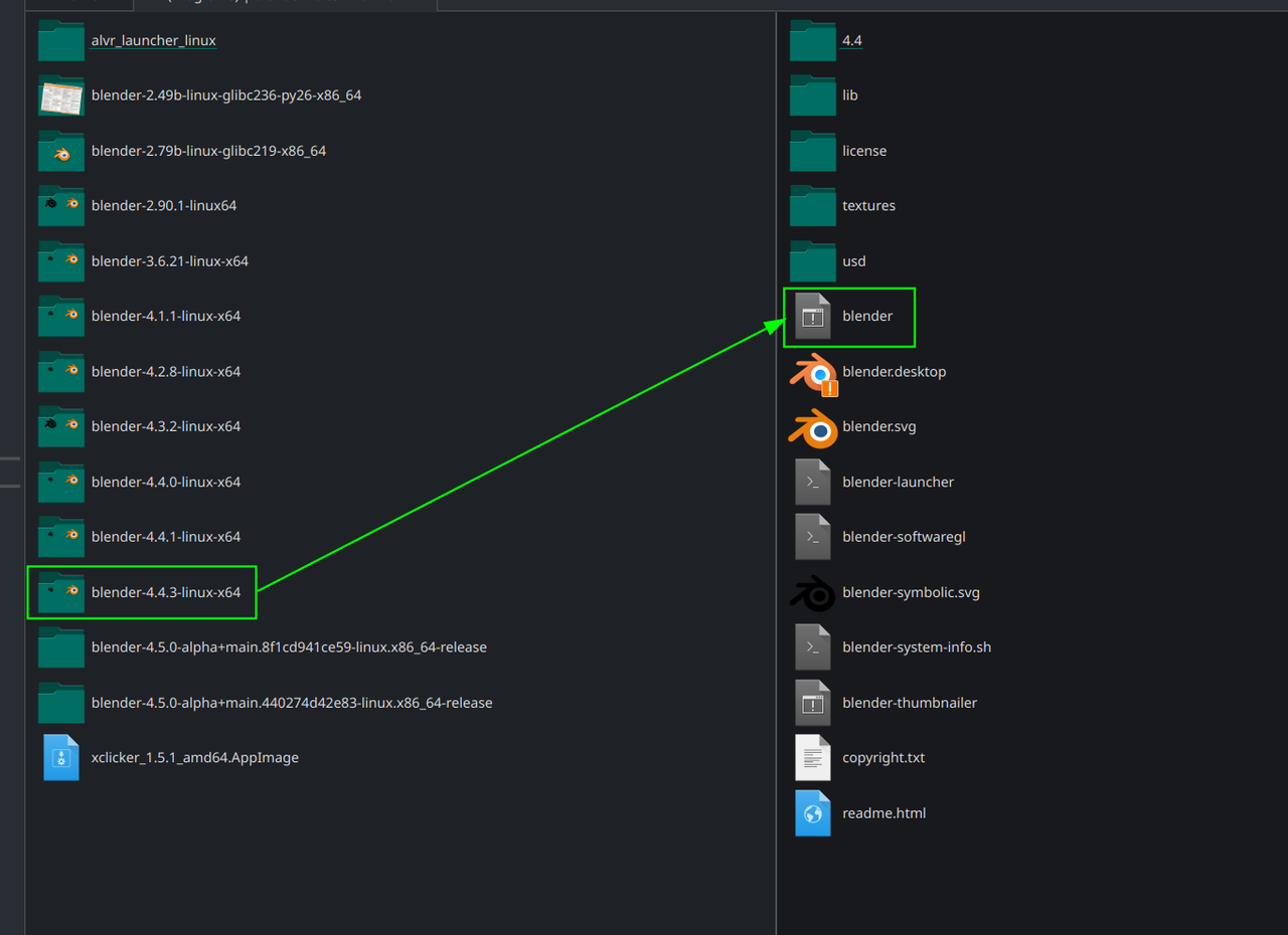

        #95239
          Once you Extracted the .tar.xz, you can click on blender to open the program:
