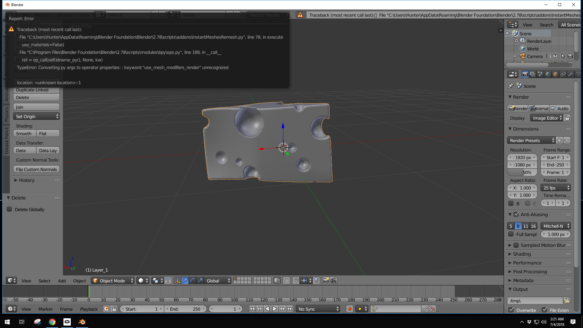

    I installed an add-on called Instant Meshes Remesh and when I try to use it, I either get a error or nothing happens.
    I can find plenty of videos and tutorials on how to install add-ons, but none of them actually show the process of using them.
    I am just trying to retopologize a super dense mesh to something workable for animations and games, am I skipping steps?

      @louhikarme i did not have that box checked, I checked it, then restarted blender, tried again and got this

        @louhikarme I did that too and I still got an error
