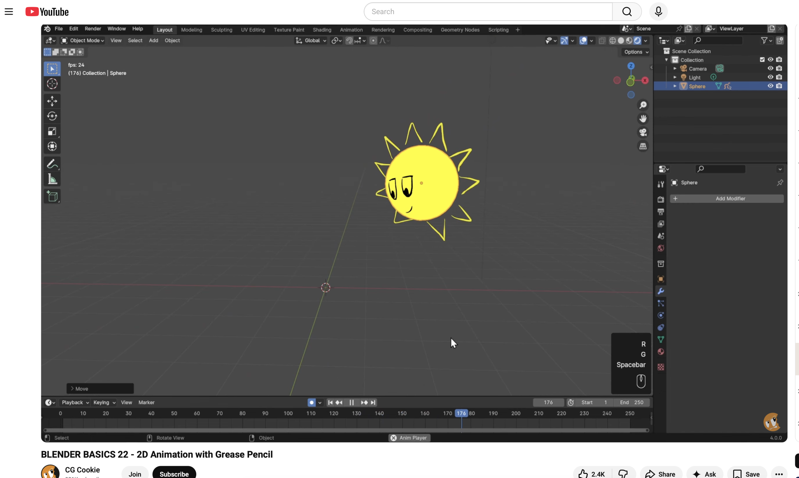

      I watched your video in Blender Basic course on how to use the Grease Pencil in 3D.
      How would go about setting this 2D animation as an overlay to a video in Blender video editor?

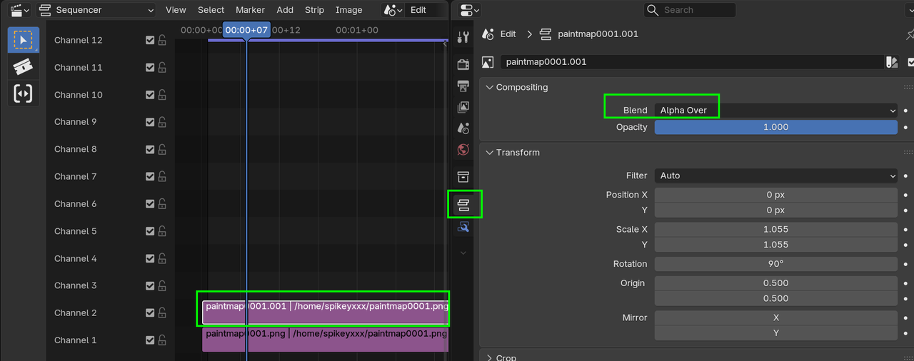

        Hi Eugene,
        If the GP Animation has an Alpha, you can simply place the Strip above the Background Video and set the Blend Mode of the top (GP) Strip to Alpha Over:

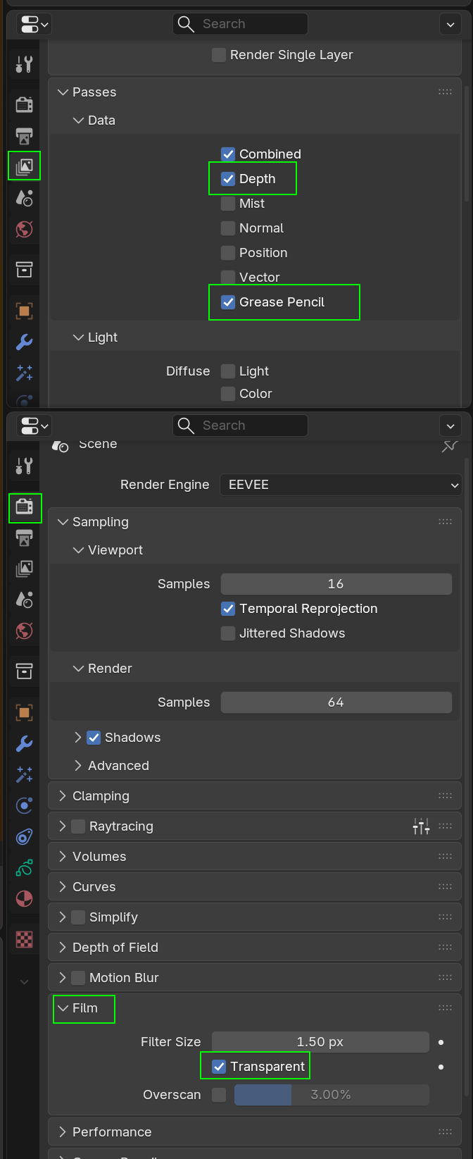

          #99574
            Set the Film to Transparent, before Rendering:

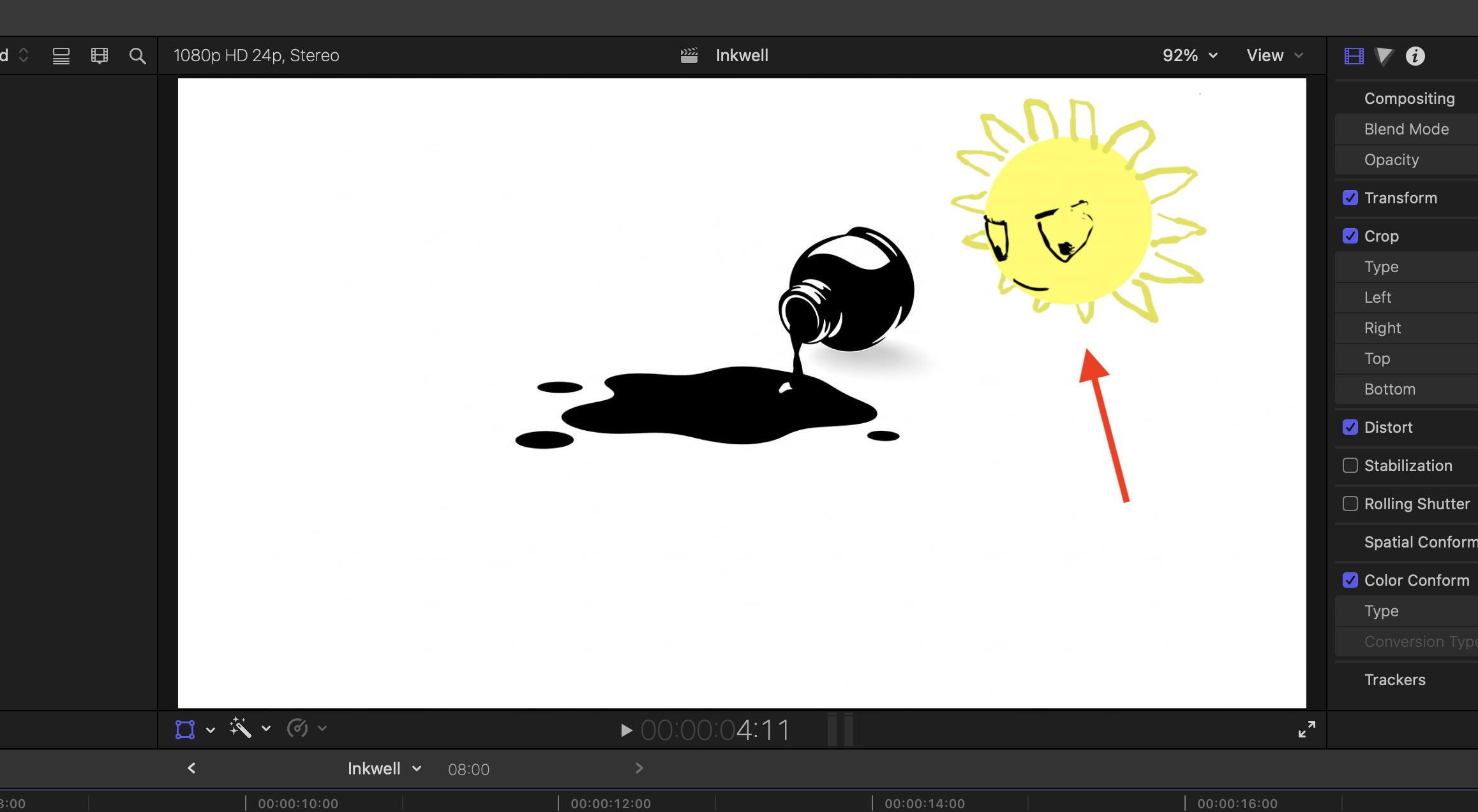

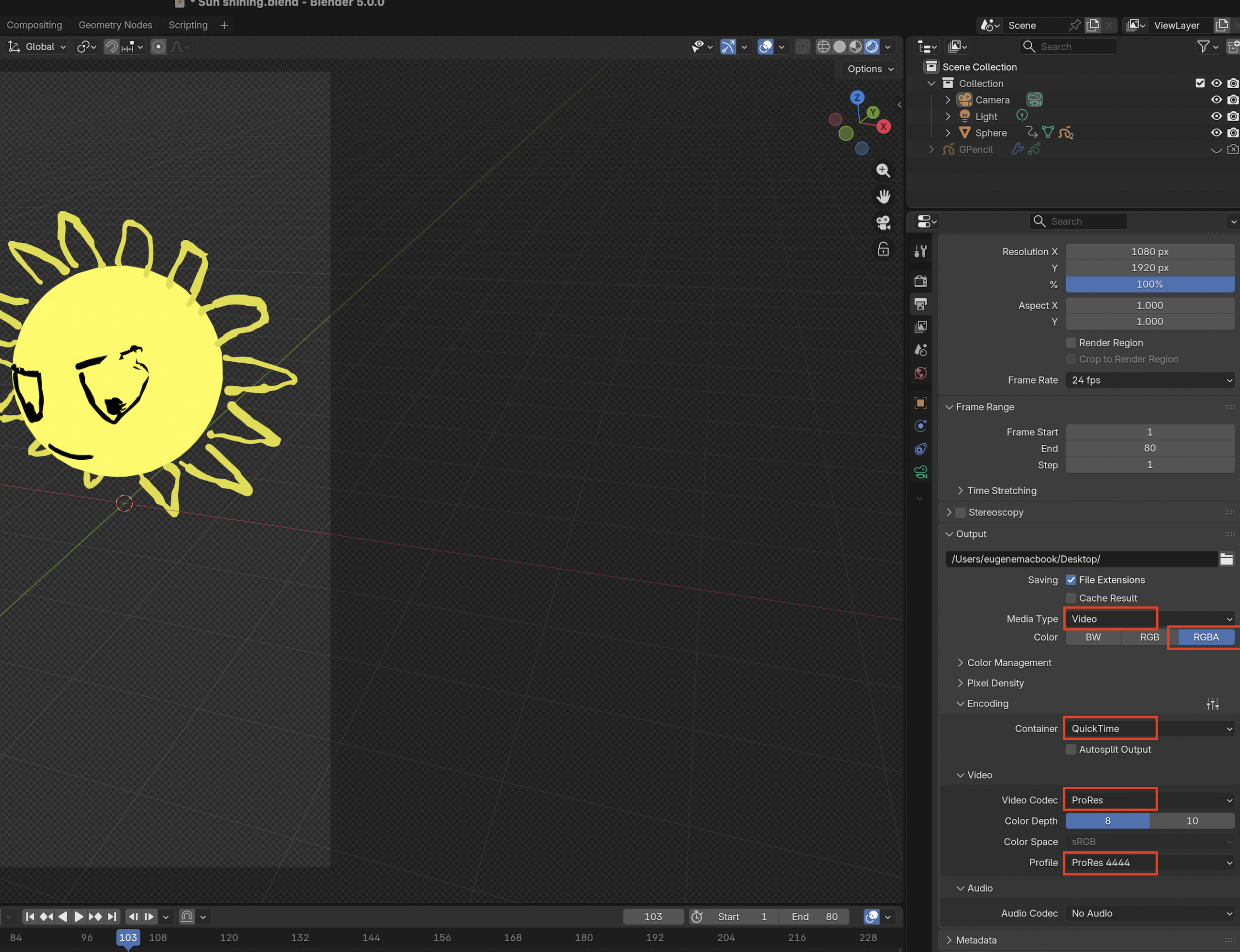

                Hey Martin, I didn’t do overlay in Blender yet but I did it in Final Cut Pro and it worked.! The animation done with GP is transparent and is working fine on top of my video – Sun is shining baby 🌞.  I thought you might want to know.
                In addition to checkmarking ‘Transparent’ under Film like you suggested I had to select those settings in Output properties:
