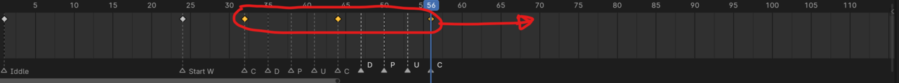

Hi, I’m trying to make a simple animation where the character will start idle, I keep this idle position for a few frames, then there is a part where the character starts to move and then enter the normal 24 frames walk cycle. And I want it to give 10 steps (at a later stage I will transition to a stopped pose, but lets leave it for now). I don’t want to animate all 10 steps, I want to do the first and then make it repeat. If I add the cyclic modifier, than it will repeat from the first frame, which is the idle one…
Looking at the timeline:
The question is if its possible to make frames 32 to 56 repeat 10 times (without actually copying it 10 times, which would make it much harder to tweak later). This walk animation has translation forward.
