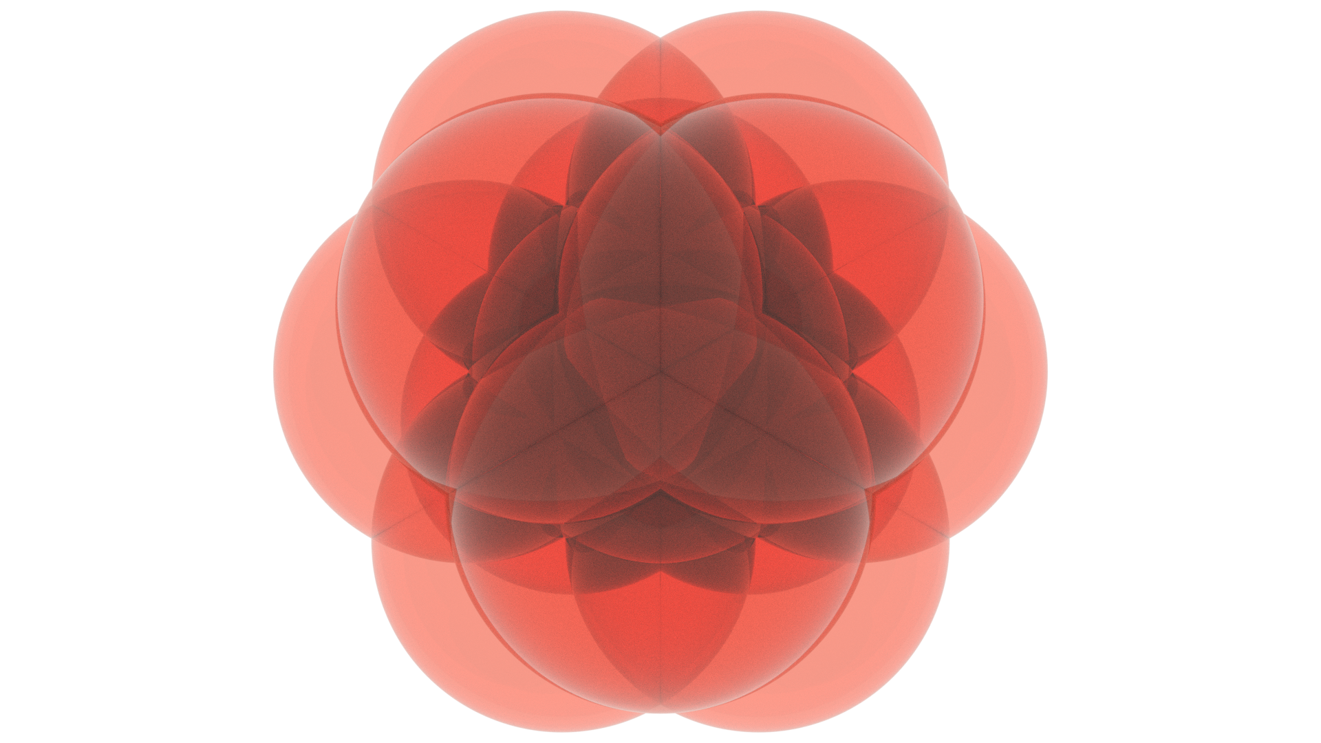

          thank u VERY, VERY, VERY much! You brought me a huge step forward. I’ll post the results here when i am finished. I am actually trying to “extract” the dark “areas”/intersections of this picture (these are the 13 spheres).
          Thank you so much one again

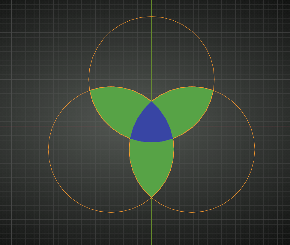

            Hi Leonardo, I am glad you found this helpful, but what you want is not the intersection of those spheres….
            Let us consider a 2D scenario. Here we have 3 circles with their intersection in blue:
            But, if I understand it correctly, you want the green+blue area.
            Which means, you’d have to take the intersection of any combination of two circles and then ‘add’ them together (in Boolean terms, this is called Union).
            See if you can do this and show the result or ask if you get stuck 🙂

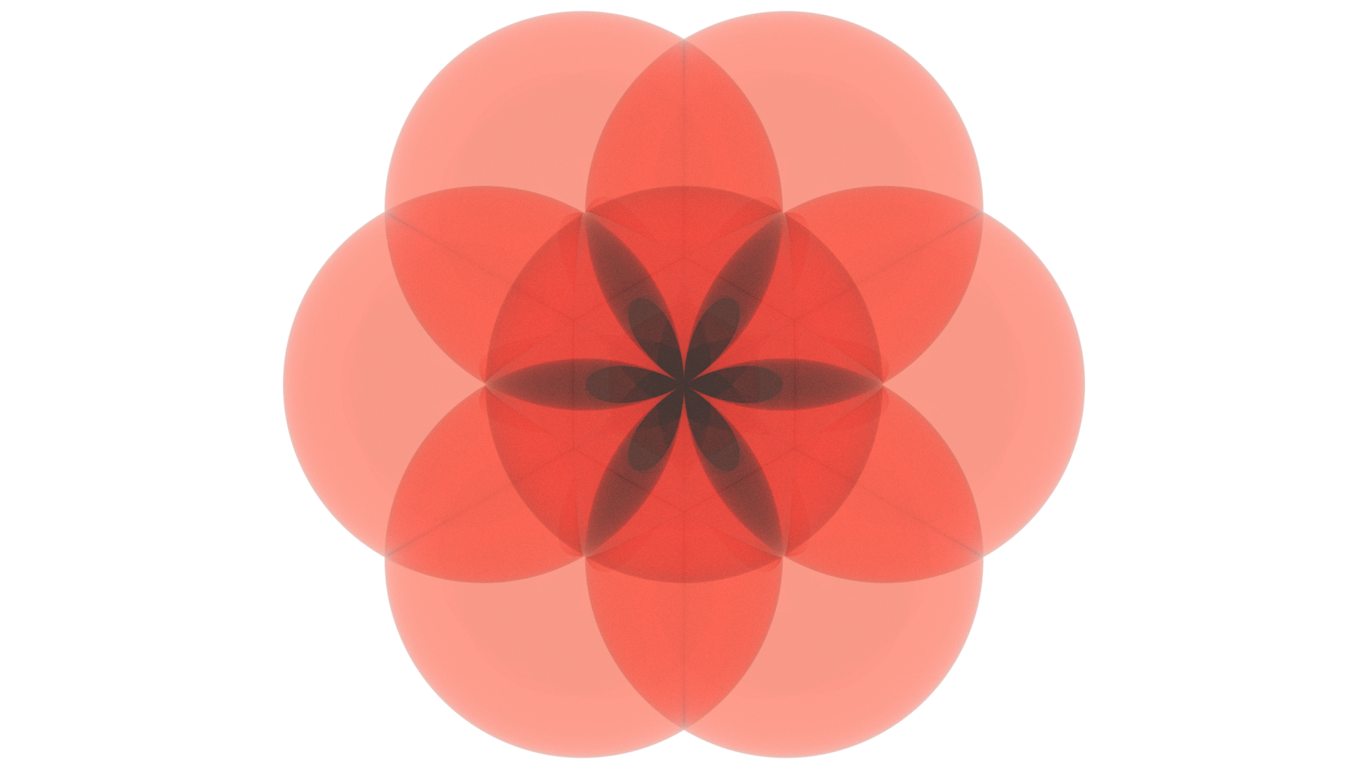

              Well, both intersections I find interesting but the blue ones are the ones that are creating the dark spaces… When I created the spheres I hoped that Blender would keep the interior of the glass spheres translucent but I was wrong… that is why I thought the best method would be to find a way to “peel off” the constituent surfaces and then look at what is “behind” until reaching the core. Ideally would be to be able to create new surfaces out of each new boundary created by the intersection and then just hide one by one until the core becomes visible….
              The basic structure of the picture posted above is this one here:
              I then rotate this plane around different axis  and get the picture posted prior to this posting.

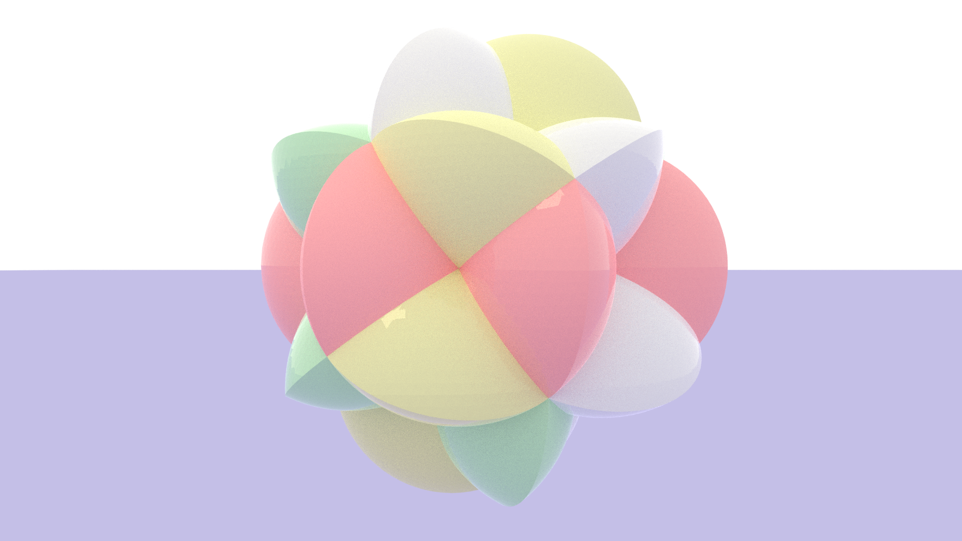

                  so here are the small intersections with a little bit of colour

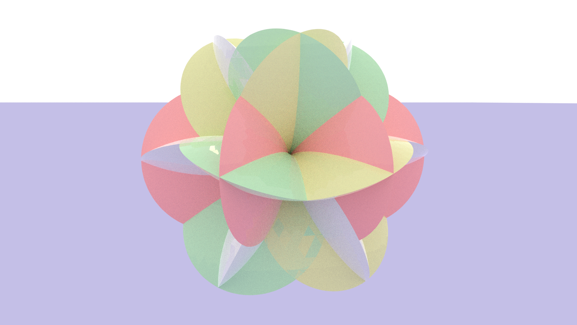

                  and the big ones
                  and here the big ones enclosed in the spheres
                  thank u  @spikeyxxx once again for your help
