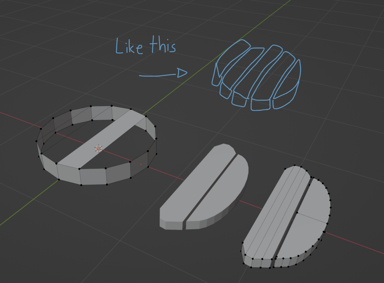

    Does anyone know if it’s possible to make a floor or table that looks like a circle composed of wooden parts? Without making it look like that using materials and textures.
    Do you have to model an individual piece and then put them together or can you make a cylinder and make it into separate pieces somehow?

      I’d start with a Plane, cut some Loop Cuts, Bevel them and Delete the newly created Faces and use a Boolean Intersect with a Cylinder. Then give it some thickness:
      You can also start with a Circle (Filled with an NGon) and connect ‘opposite’ Verrtices, where you want the cuts, with J and the, Bevel those cuts and Delete the Faces. Then add thickness. This will give you planks of varying width.

        That works! Thanks 🙂
