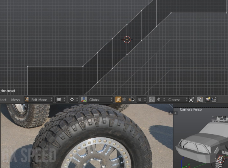

                  What is the name of this instructor? I like the fact that he chose to model the tire with much more complicated pattern (as the screenshot below), and use the Multiresolution modifier to sculpt the details. It is indeed a goodie!
                  #75210
                    That is the great, the legend, the superstar, the genius, the phenomenon, the one and only Jonathan Williamson. I’m glad you found it useful Naiad.
