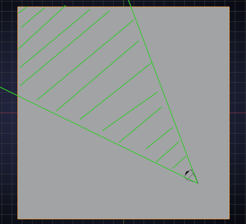

        While working on the composition, I’d use as simple as possible primitives as placeholders for the trees and such.
        When rendering, you could render it in ‘parts’ (foreground, middle, background,….) and then composite those parts over one another afterwards.
        Also make sure that you only have particles where the Camera sees them:
        Here is a great trick to use to get dynamic camera culling: https://www.youtube.com/watch?v=Maqs85Lgj5Y
        Erindale uses Geometry Nodes in that video, but the exact same technique also works with the ‘old’ Particle System.

          I used primitives to layout the scene, and tried to have as little detail as possible in the view port. The render part was ok, it take some time to load all the elements but nothing terrible.
          this trick is good, and I didn’t use this. i sccatered all over, but in the view port it was disabled from view. But something that I noticed is that some times a big plant popped into view with this trick, and the foliage should have appeared sooner. some trees in my scene were out of the camera view, but the foliage appeared. I will try to use the trick with some kind of falloff.
          [edit: in the end of the video he addresses this issue, but in the beginning it still happened]
          but I think my biggest problem was with the vert count of my trees. Mother nature giving me a lot of headaches.
