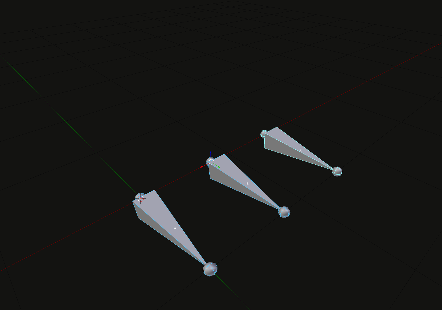

        Add your armature and add a bone for each cylinder. Here they are labelled A , B and C :

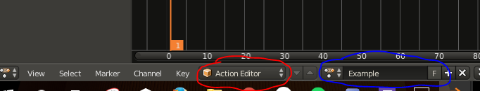

        Parent the cylinders to the bones so you can animate the bones and the cylinders will move too. Now go into pose mode and open up the dopeshet , select action editor (CIRCLED RED)  and add a new action with the plus button and name it (CIRCLED BLUE) I called mine “Example” :

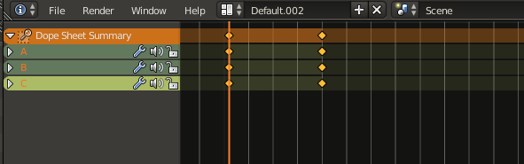

        Now keyframe the bones on frame 0 , animate them all the same how you want (in my case I went to frame 20 , dragged them along the Y axis in the 3D Viewport a bit and keyframed them again) You will see the keyframes in the dopesheet represented by white diamonds (or yellow when selected) :

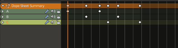

        Now you can move the keyframes of each bone in the dopesheet by selecting them and hitting G , to offset the animation.(Remember to select the start and end keyframe when moving to keep each individual animation the same length)  Here I moved bone B along and C a bit further :

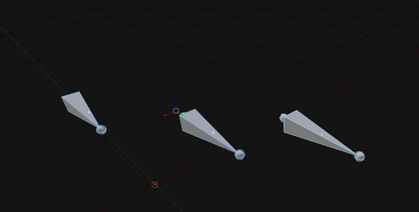

        Now you can see if I jump to the middle of the animation , that the bones are moving at different times rather than all at the same time like they were originally keyframed to do  :
