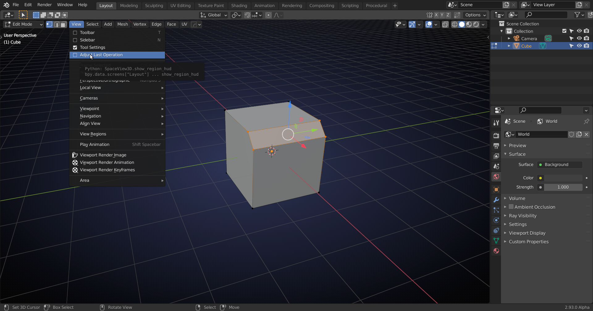

        If you see nothing at all, you might need to enable it here:

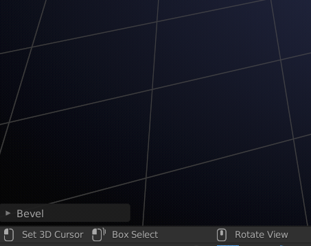

        Then you may need to ‘open’ the popup by clicking the little triangle:
