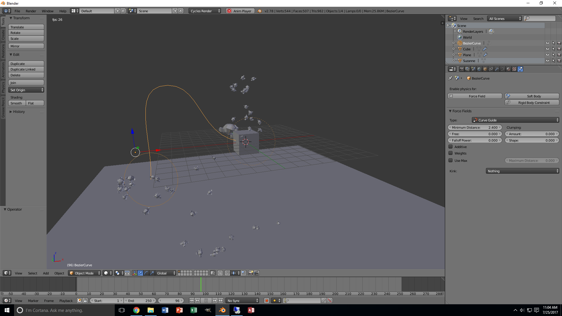

      I was testing out the curve guide feature from the dynamic simulation tutorials, but when I created a curve guide the start point was in the wrong place. Is there any way to flip them?

        In edit mode for the curve, go to the toolbar and click on Switch Direction. That should do it!

          Thank you!
