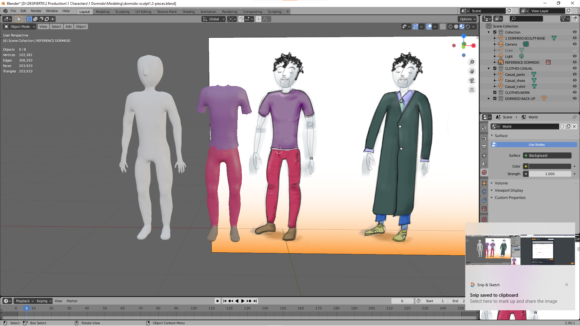

      I´m creating my own character for a short film I don´t know which it´s the best approach to later Rig and animate the character.
      Is it correct to separate the clothes and keep the original basic mesh behind the clothes?
      I want to model 2 types of clothes for the film as you can see in the image:
      And another question:
      Is it recommendable to make the retropology of the character with the workflow you are using for latter Rig it and animated?
      Thank you so much for your brilliant courses and suppoert.

        Go with the dress up technique,. You can always transfer the vertex groups from the weight painted body or use it as a collider and do cloth simulation if you have the processing time/power. Deleting any non-visible mesh is mostly for optimizing for game engines.
        Yes retopo is important for any deformable mesh. robots that move along joints and hinges not so much but any organic character that moves by muscles you need to make sure that the quads flow evenly much like how skin does.

              One thing you will learn about Blender / 3D is how relative every task of the workflow becomes. There’s rarely one complete answer for a 3D question.
               Is it recommendable to retropology the clothes then?
              Retopology is merely a method of achieving clean, even topology according to the template of another shape. Some people prefer to model clothes from scratch with even topology in which case retopology is unnecessary. If you’re sculpting your clothes first, like in the course, then yes, you will need to retopologize clothing for the sake of animation / simulation.
              Separate the clothes and delete the body parts that are behind the clothes.
              This is what’s taught in the course, which is ideal for a non-moving character. When it comes to animating clothes you will probably want to keep the underlying body model. You can rig clothing to a character so it moves exactly with the body, which is easiest for clothing but not realistic at all. Or you can simulate the cloth behavior which is far more realistic and far more difficult, for which you will need the underlying body model for collisions.
