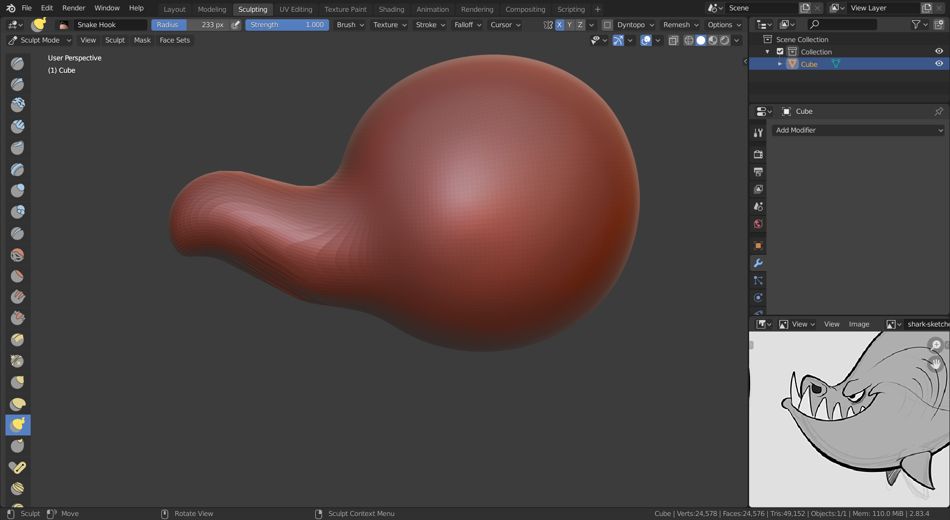

      At 5:33 he rotates the snout as he finishes extruding it with the snake hook brush.  Whenever I try that, it looks like this:

          I guess I should have put the timestamp a few seconds earlier.  You can see in my image that the initial chunk I extruded is facing the same way it used to, even though I used snake hook.  In the video, the tip of the extrusion actually rotates to follow the brush.

              Not for me.

                @williamatics Honestly it looks like your brush stroke is doing that “follow / leave behind” behavior…I can see the flow pattern in the topology.

                  But the tip is pointing forward, not upward.
                  #59334
                    It appears that you ended your stroke pointing down. So you went left, up, then down.
                    If you’re definitely ending the stroke in an upward direction but the result is pointing down, that’s an issue for sure. A funky one.

                        Maybe you messed up some (Brush or other) settings. Try File > Defaults > Load Factory Settings.
                        #59337
                          Ahh ok, it looks like you must have turned the Rake setting off for the Snakehook Brush at some point @williamatics:

                            Thank you!
