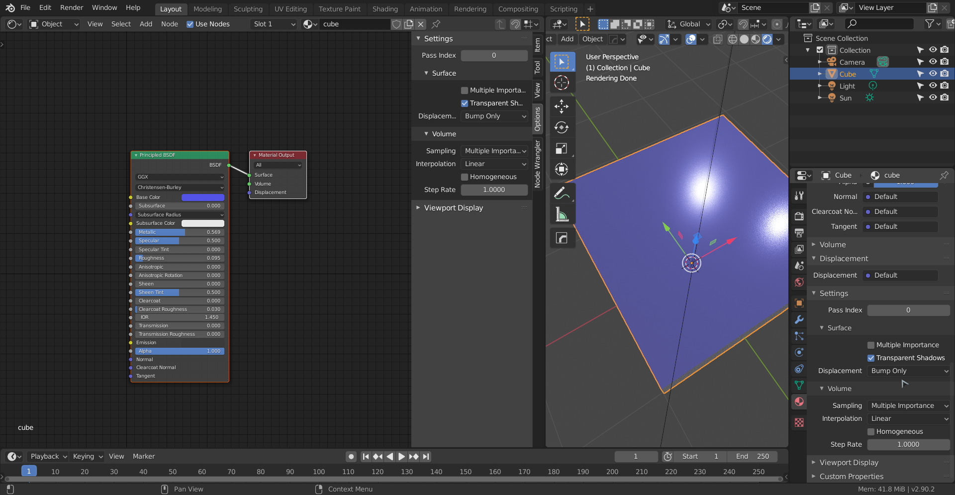

            There still is MIS for Materials though.
            When a Material has a large area emissive component that is weak compared to the overall lighting, turning it off (it is on by default) can reduce the noise:

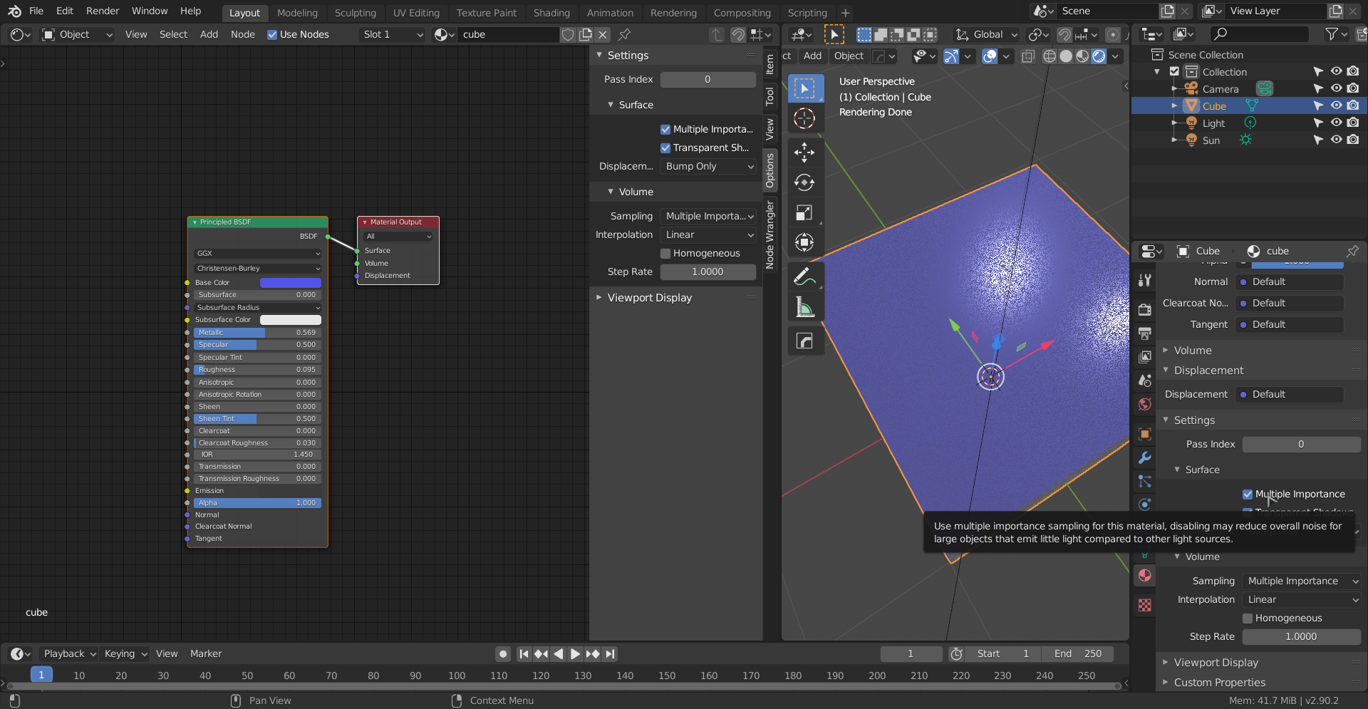

            and with MIS turned off:
            (The Cube has a slight emission on it!)
