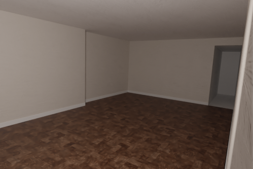

          Thanks @marksmith ! I tried to place ceiling lights of different kinds and some HDRIs but nothing results in this flat saturated lighting. Here is the one created using photography softbox just below the camera in the scene.
          I suspect the photographer had their camera flash turned on causing this flat lighting of the scene but I don’t know how to simulate that correctly. Should I simply place a point light and turn up its power?

            in that case I would try an area light in a position that the camera person would use…
