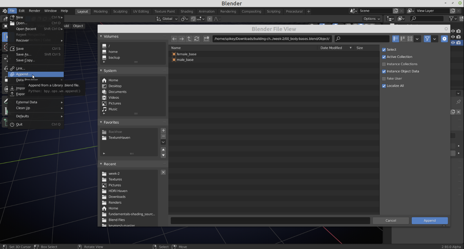

      Hello,
      I tried to open the Basic Body Mesh Files that were available in the “Modeling Realistic Characters with Blender” Course. The Problem is, that it changes my brush settings for sculpting and I would like to keep them how they are. I know that I can uncheck the “Load UI” option, but that does not prevent my brush settings from changing.
      How do I load just the body mesh ?
      #63017
        Open a new .blend file and Append the body mesh Object:
        I think that should work.
        #63018
        nico1109
          Thank You it worked
