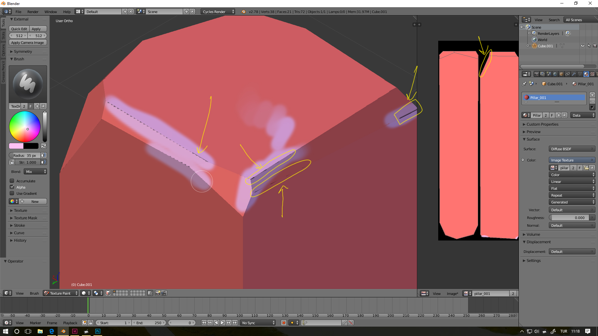

      Hi,
      i having a slight problem when painting
      and i could not find a solution to that
      How can i overflow to the edge when painting?
      #30858
      Jonathan Lampel
        In the texture painting toolbar, under Options, there’s a setting for bleed. If you increase that then it will overflow the edges:
