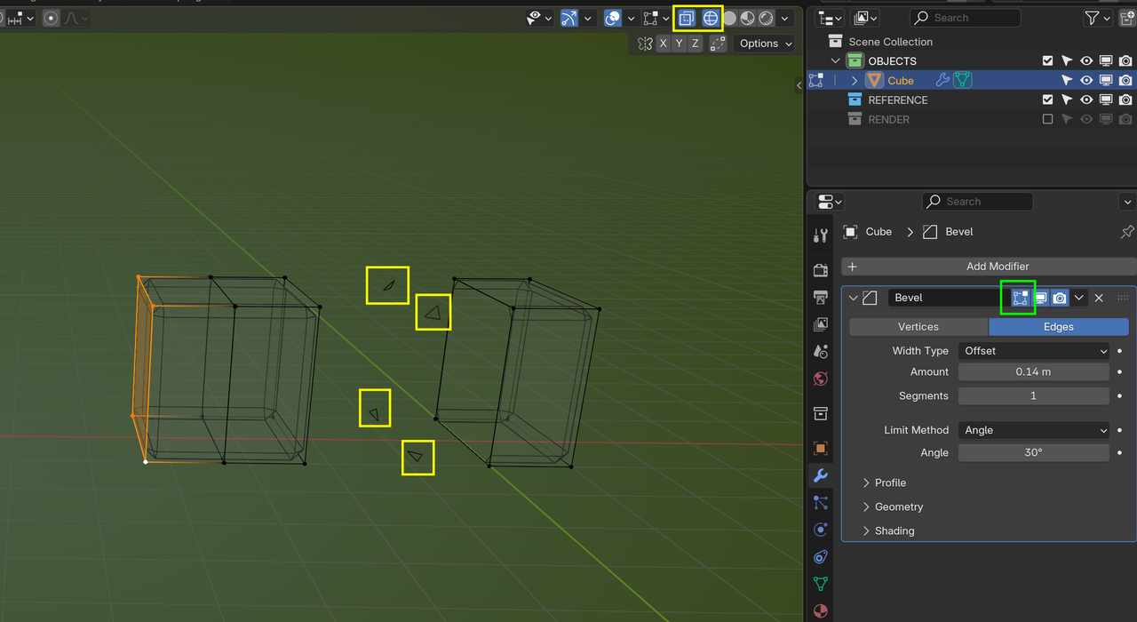

            Hey @jagan ,
            That sounds like this situation, you Hide Vertices with H and are in Wireframe Display Mode, then Blender will still show the Bevel of those Hidden Vertices:
            This is only in Wireframe. You can ignore it, or turn off the Edit Mode Display in the Modifier (which I personally prefer; it makes the Modeling easier for me).
