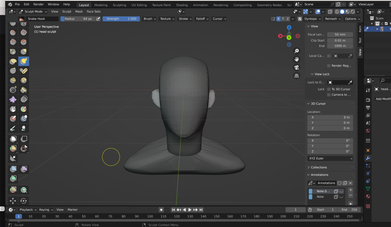

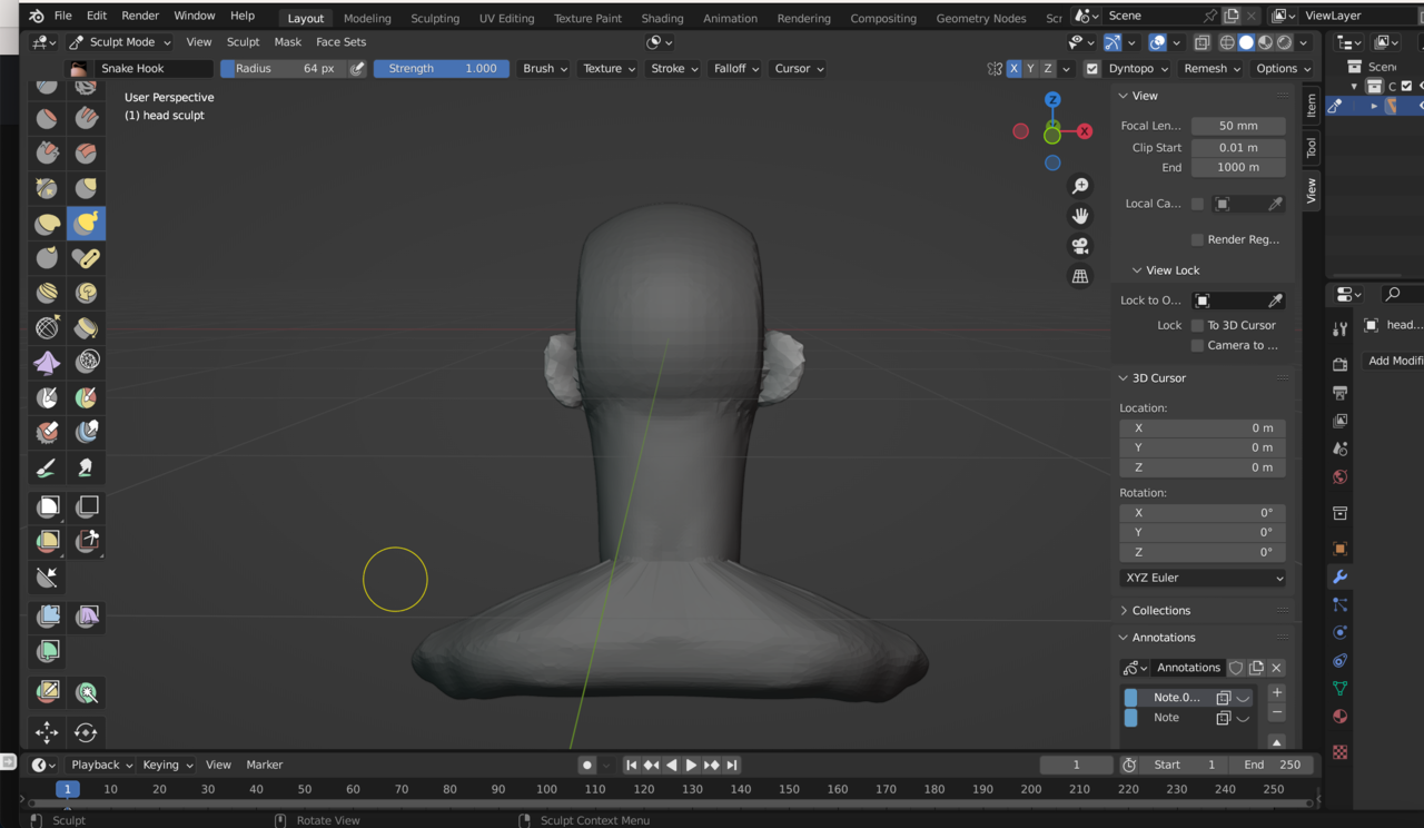

Hi, why does the ear not look symmetrical?
Forum Archive Hi, why does the ear not look symmetrical?
  • #16092
    hashneet uberoi
      #78123
      hashneet uberoi

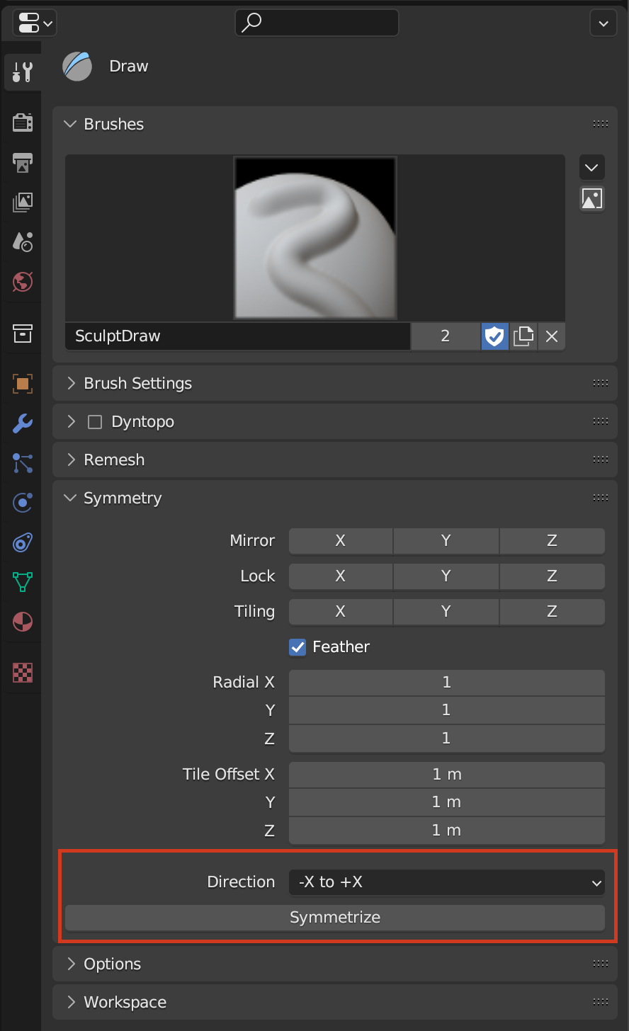

          I believe sometimes Blender doesn’t quite mirror things with 100% fidelity and things add up and before you know it you have one ear longer than the other. Don’t quote me on that though, but I think that’s how things go. Fortunately there is a symmetrize option,you just need to specify the direction you wish the symmetry to be applied at and hit Symmetrize.
          #78125
            Omar is exactly right. Especially with dynamic topology, symmetry is rarely perfect since geometry is being generated on the fly. The symmetrize button will make it perfect. Non-dynamic-topology sculpting is usually better about maintaining symmetry when sculpting
