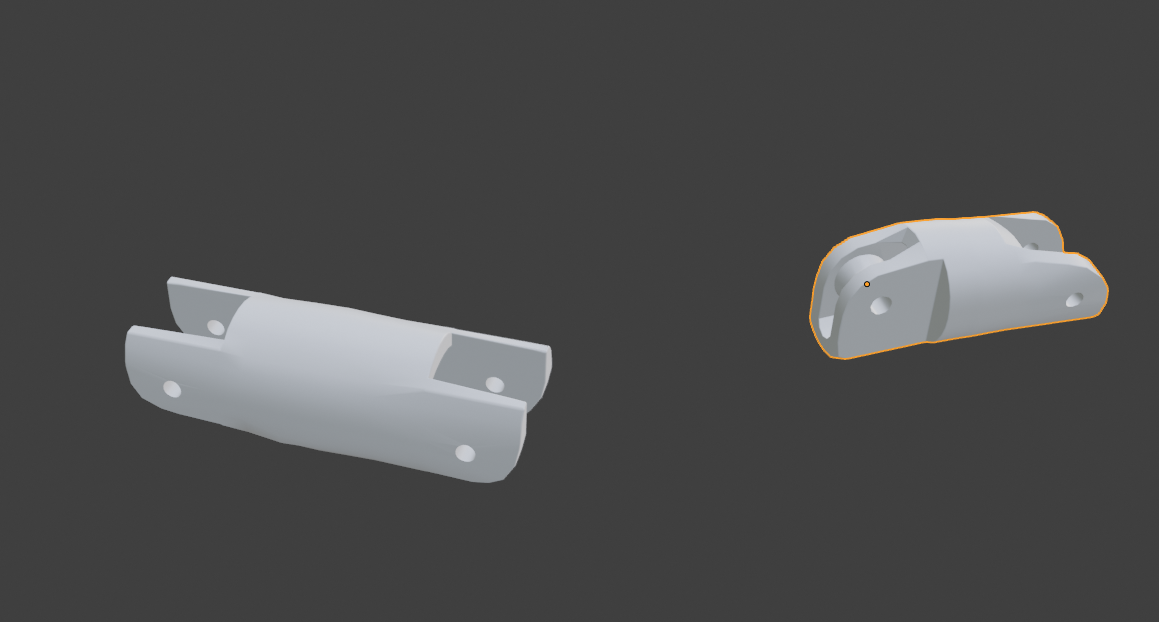

      How can I clear a child paren relationship, without moving the child. I have this
      The object on the right is the child of the object on the left.

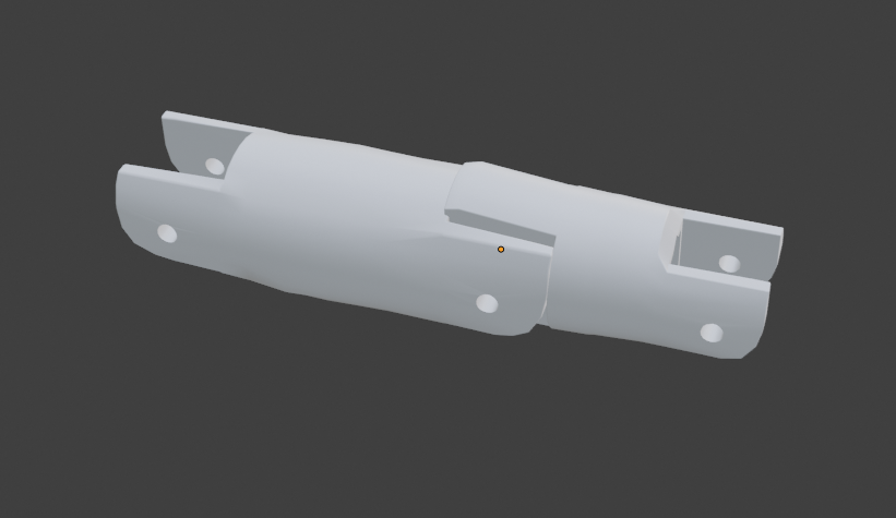

      Whether I Clear Parent on the child, or Clear And Keep Transform, the cild moves:
      How can i clear the relationship and keep the child in it’s place?

        Ahhh, sorted it out I think. Ihave to move the cursor to the child object, then Clear Keep Transform works.
