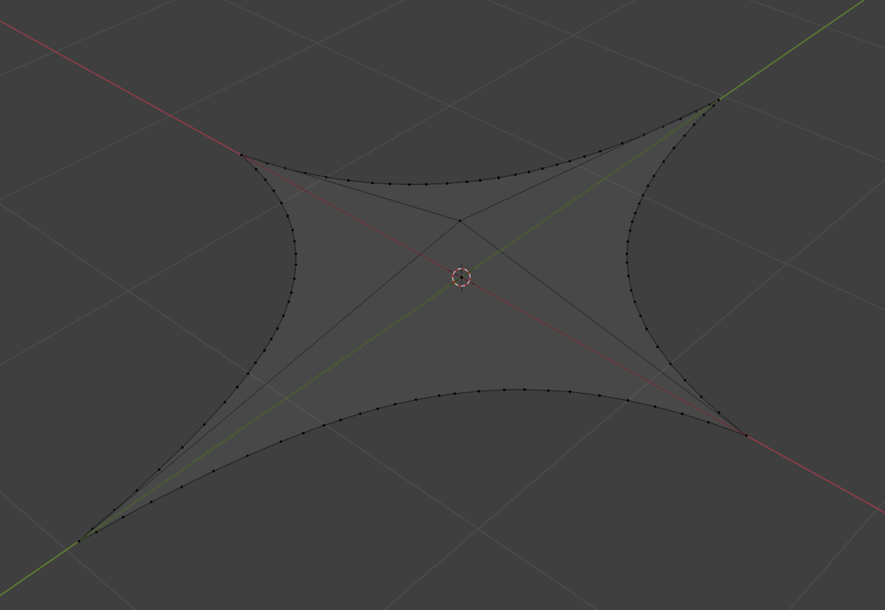

      Very new to modelling and attempting to model this star shape from a reference. I’ve traced the general outline, but not sure of the best way to fill in the rest of the geometry. Any help greatly appreciated.

        That is looking good. You are using a lot of vertices to define the shape, you can probably delete 70% of the excess. Also it’s a symmetrical shape, you can just model 1/4 of the shape and with the mirror modifier get the rest for free.

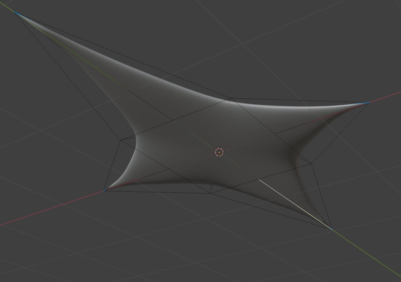

          Thanks very much Omar – I’ll look to reduce the amount of vertices there. Yep i have a mirror modifier enabled. I have done the Core mesh modeling a few months ago, need to brush up on things though.
          I guess my main question was whether I needed to add any extra geometry on the four main faces, or if what I have is the right approach?
          Since I have basically four mega N-gons I thought I must have gone about it the wrong way..
          If I subdivide it, I get a really strange result which I’m not sure where to start on fixing

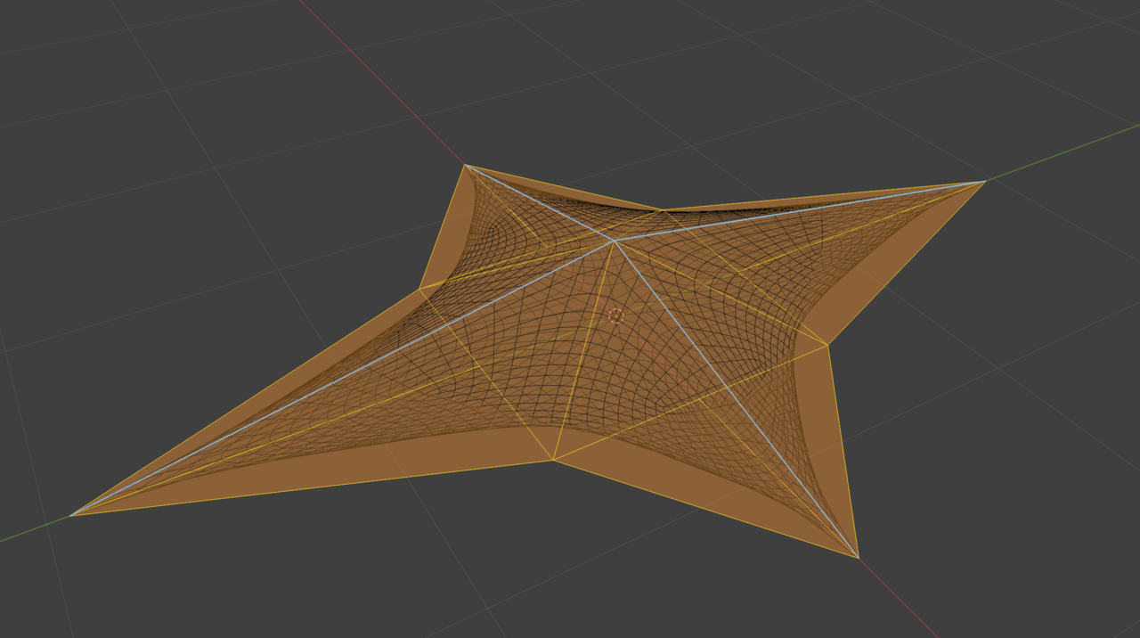

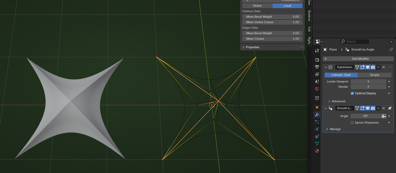

            Hi Jack @jack___ ,
            How about using Vertex and Edge Creasing, something like this maybe:
            #93648

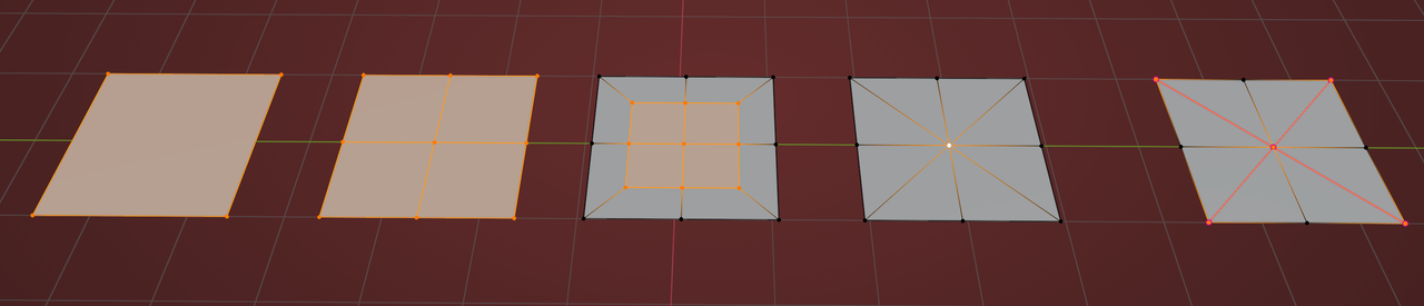

              If you use the following method  to get started, the whole thing should take you less than a minute to model.
              Subdivide a Plane, Inset, Merge at Center, set Creases:
              #93649

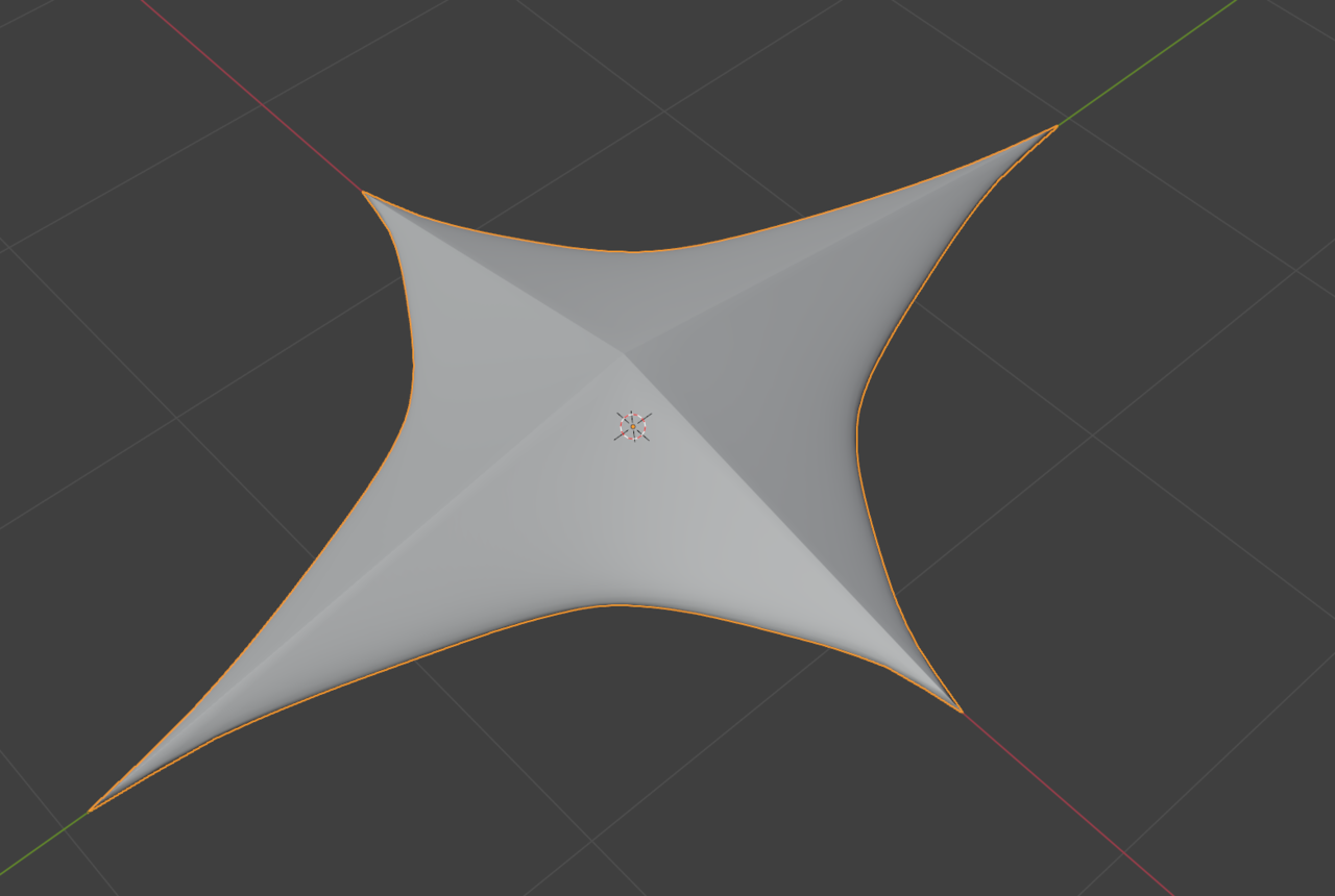

                If you want to model with the SubD method, you can easily trace the shape with like 8 vertices to get the curve and then just a straight edge towards the middle. You could also try Bezier curves.

                  I did try tracing the shape and adding straight edges to the middle, but got weird results – most likely an error on my end.
                  The plane method worked really well. I wouldn’t have thought to start with that, suppose I just have to practice these little geometry puzzles to get the hang of it.
                  It’s nearly perfect now, and good enough for my use case in a logo animation. But out of curiosity, if I wanted to sharpen the bottom edges, but keep the curve, how would I go about that? I think I need to add supporting edges, but I’d need quad topology to do that wouldn’t I (at least on the bottom face)?

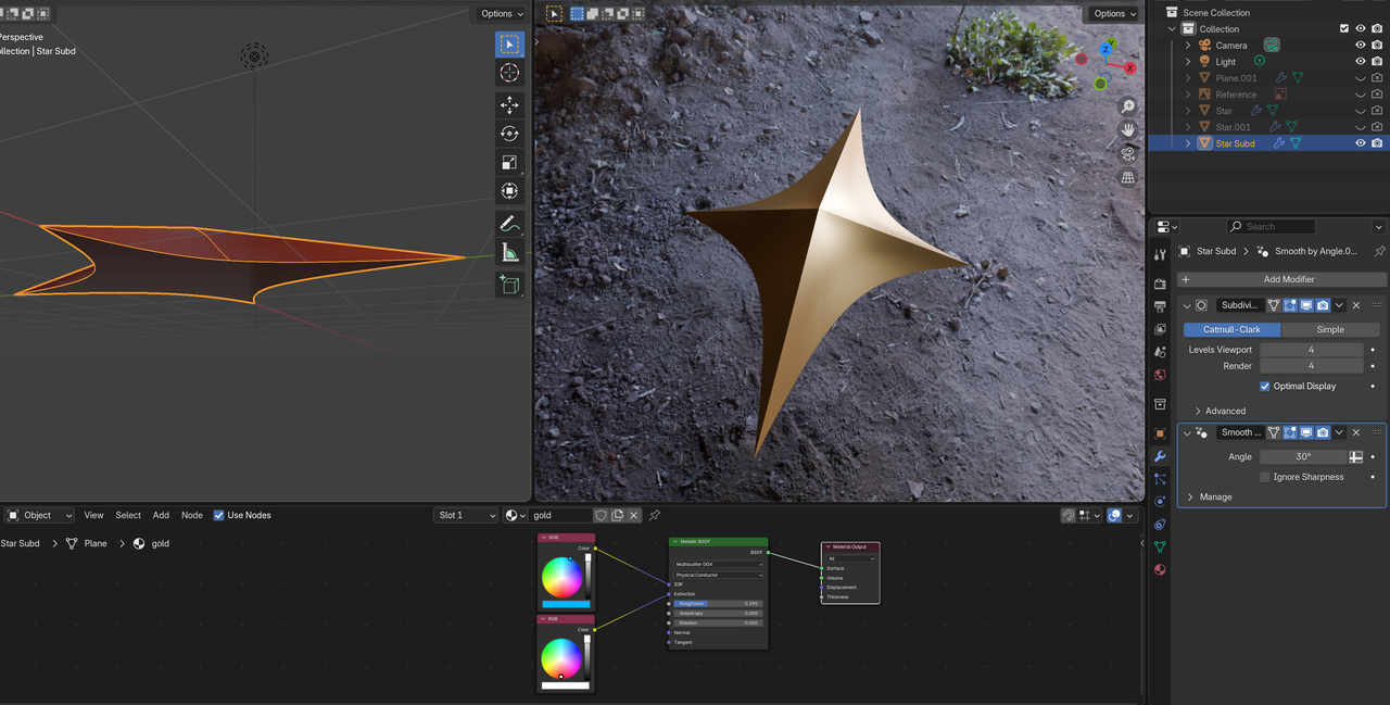

                    I removed the Bevel Modifier, made the bottom 1 single Face, added Creases to the Edges surrounding that Face and think this looks fine:
                    Here’s the file: https://drive.google.com/file/d/1CPH3ui0g-og98tk_xeBg7TeYSf_qHHY4/view?usp=sharing

                      Yes that’s perfect actually! I forgot to add back the shade auto smooth when I tried.
                      The material is a nice touch also. Thanks again for going above and beyond.
