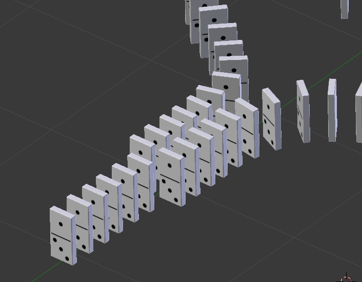

      I made duplicate links objects of the fist domino piece and now all of them have the same amount of spots on them. I tried making them single user, but it does not change the texture. How can I make the pieces have different spots on them again? I know they did when I started this exercise. I don’t want to start all over again.
      #26859
      Jonathan Lampel
        Hey Wilco, the random spots are part of the material and I’m not sure if they show up that way in the viewport. Try switching to rendered view – do they still have the same number of spots?
        #26860
        Wilco Wilbrink
          That’s it! Thank you. I was looking at viewport shading on ‘texture’  or ‘material’. In ‘rendered’ view it works. You where spot on 😉
