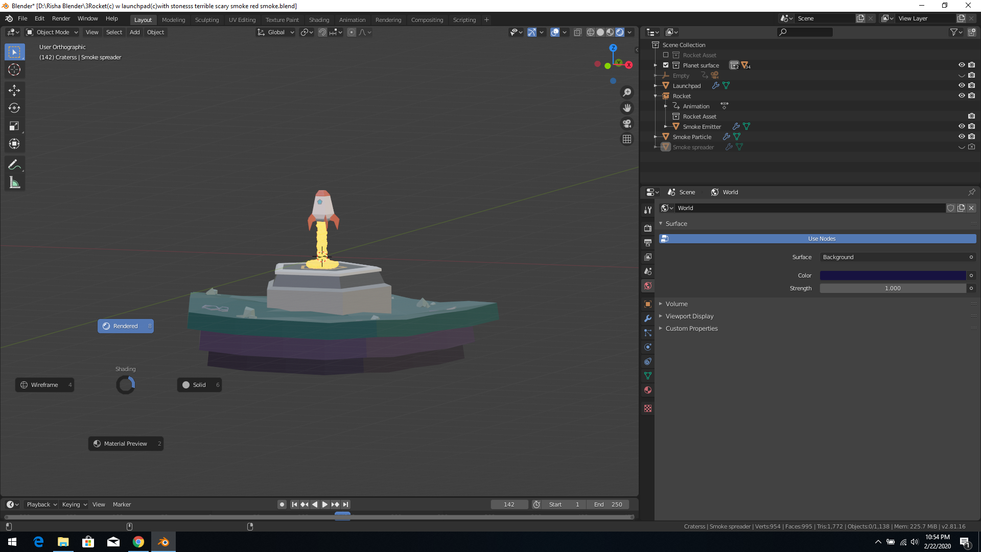

Hello! In Eevee viewport, the view between Material Preview and Rendered does not seem to change.

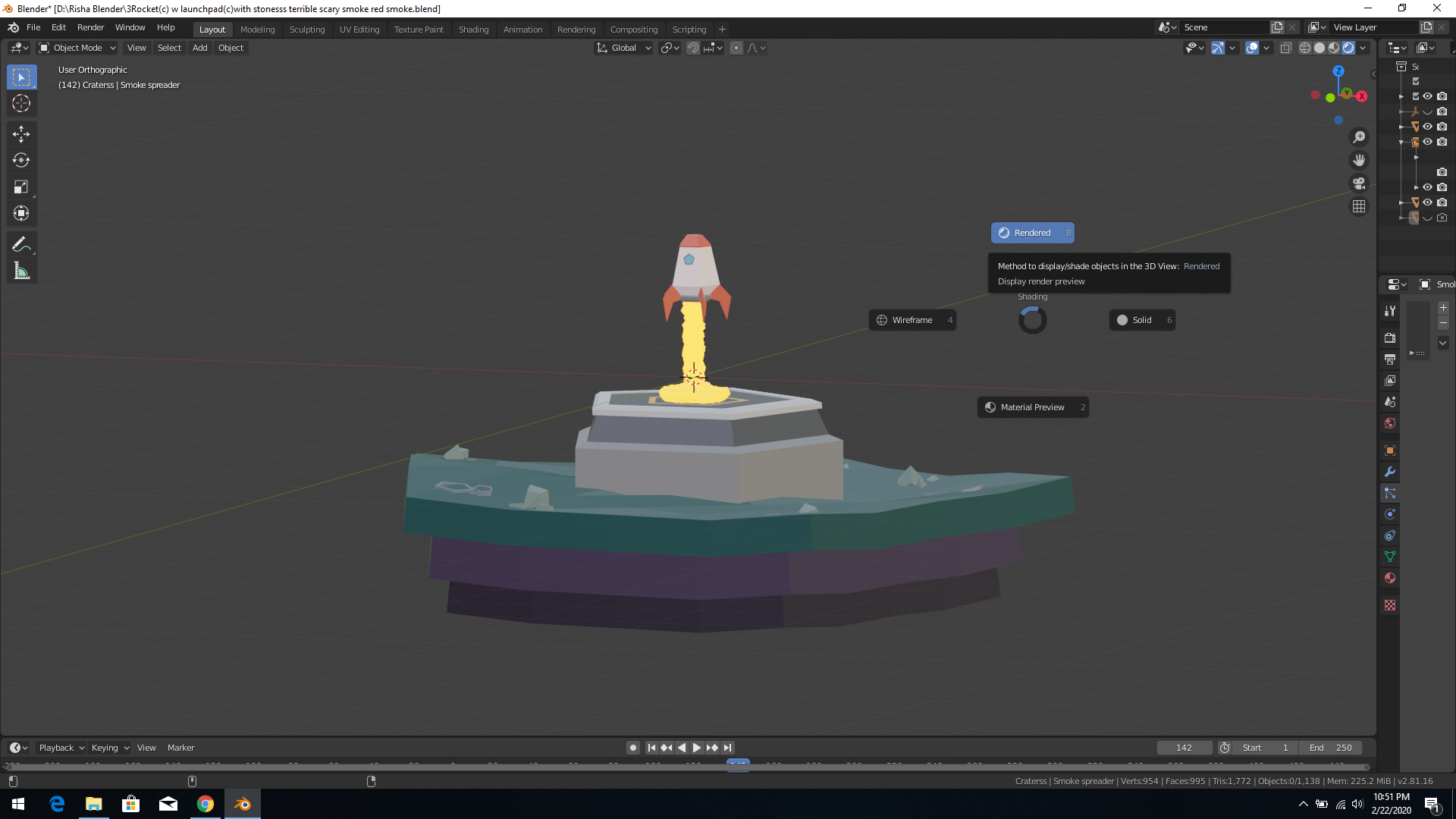

      ^This is in rendered view

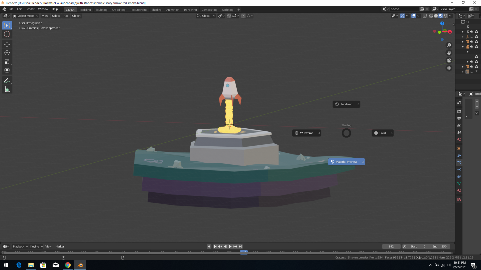

      ^This is in material Preview
      ^I’ve also changed the colors of the background as seen as time 1:43 yet there are no color changes.
      It does work when I rendered the image and the mp4 rocket video turned out well, I just hope there is a way for me to see a rendered version in Eevee viewport as well.  Currently in 2.81!

        HI, my guess is that you don’t use Scene World for lighting, which means that Blender uses the Preview World. That is why there is no difference between Preview and Rendered Mode and why changing the World Color in your scene has no effect. This is what you have:
        And this is what you want (well, not what you really want…):
