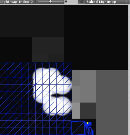

      OK, I have made a scene (HDRP) with a set of spotlights in a grid. They are all identical: static, mode:mixed, volumetric off, shadow map on. When I bake the lighting, I get random results.
      The good ones show a large “spot” on the terrain. When I toggle the enable checkbox in the Inspector, the spot goes on and off. Scripts can control the intensity.
      The bad ones have a small spot. Toggling the checkbox has no effect. Scripts can’t control intensity either.
      Attached is the baked lightmap view and the shaded view. Any clues much appreciated. Using 2019.2.0f.1.

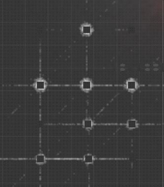

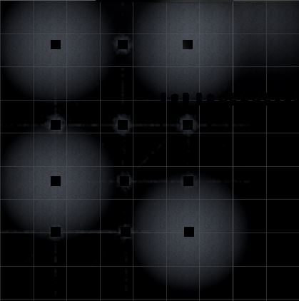

          Another big clue. I created another scene with just a grid of spotlights above a plane. With 4 spotlights enabled I bake, I see 4 light spots in the editor and all 4 work normally. If I increase to 8 lights and bake, I see 4 spots in the editor (on random lights) and only the lights with visible spots work. I tried increasing to 12 and 16, and always get 4 visible spots / working lights, at random locations.

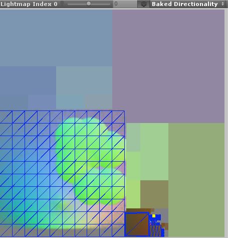

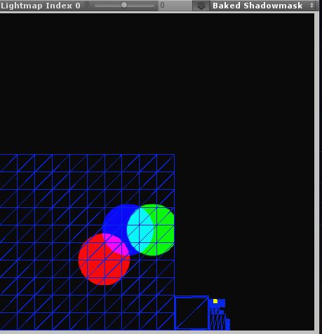

            I created a brand new project from the HDRP template, and added just a plane and 8 identical spotlights. (And of course HDRP settings and scene settings.) Almost everything has default values. When I bake lighting, I see 2 spots in the lightmap (which are stuck, I guess they really were baked) and 6 lights which work (presumably real-time). Directionality and shadowmask also look odd with different lights in each one.

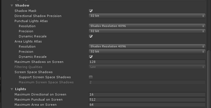

                You could also increase the amount of shadows/lights you can use in your scene. Since we’re using HDRP you’ll need to modify those settings in the HDRP asset created initially. Here is a screenshot of where you can update that info:
                Click on the HDRP asset in your project panel, then in the inspector locate the “lighting” section. You’ll see the settings shown in the image near the bottom of this section. On mine max shadows is set to 128. You can bump that up to see if that resolves the issue and/or use shadows for lights that actually need it.
                While I doubt you have that many, you can also increase the “Maximum Punctual on Screen” light setting. Punctual lights are spot/point lights.
