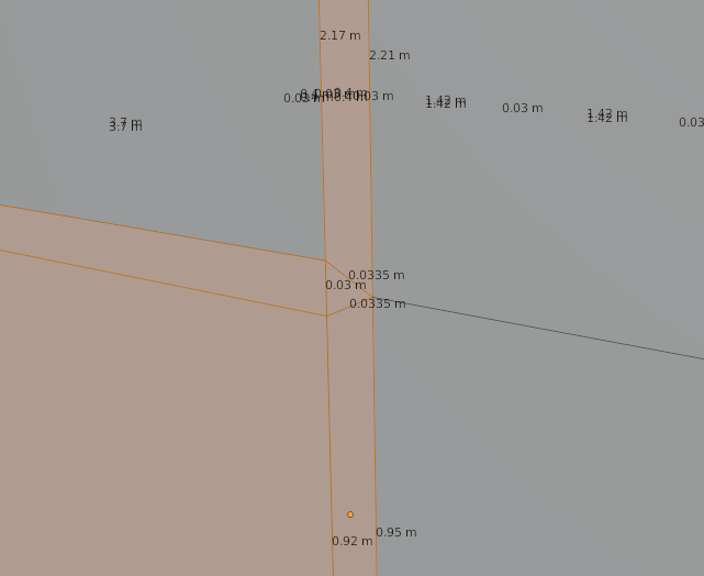

Whenever I bevel the windows, I end up with a structure like this, which I think is correct
However if I try and inset afterwards there are some faces still hanging around. It seems to happen regardless of whether I’m in face select or edge select mode. Not sure how to get around this.

I can’t return to that state since I didnt make any backups, but I can upload my mesh as it is now if it helps. I have also made a little experiment and I can reproduce the problem very easily.
You make a cube with some edge loops (resembling the windows in the tutorial).
You put some edge bevels on it. After the bevel, I deleted duplicated vertices (there were zero of them).
Now you apply an inset with depth only and there you go. Changing the parameters does not seem to help either.
