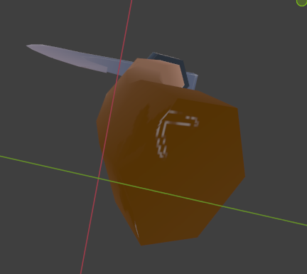

      When adding the detail layer, in Blender 4.0.2 I found I’d get a white halo around my strokes, as below.

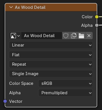

      Blender has added a new option that tells blender how to interpret “Alpha”.
      You will need to ensure that it is set to Premultiplied before you start painting:

          When I created the texture, the alpha was set as “Straight”, so it seems to be a weird default?
          Premultiplied alpha is pretty normal for realtime Vulkan/OpenGL stuff, but it loses some information over non-premultiplied, so while Blender could want to preserve the RGB channel rather than blackening it for alpha = 0, it apparently didn’t account for that when it fired it at the screen.

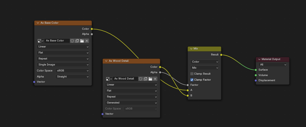

              No, straight is good, though it depends on each situation. Can we some screenshots? Node tree, render, viewport, etc.
              #84206

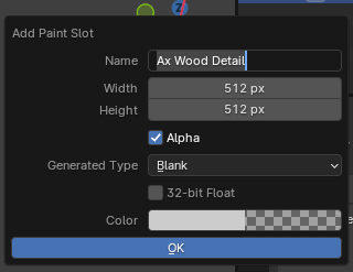

              Matt Bob
                I think Straight may work, but the image must be black, not white when creating it (which makes sense actually):
                Creating from the texture paint view in Material mode, adding a base color
                #84207
                Matt Bob
                  Image layer + final composited layer in shaded view:

                    A final silly demonstration:
                    versus:
                    Notice there is no black halo and everything works properly.
