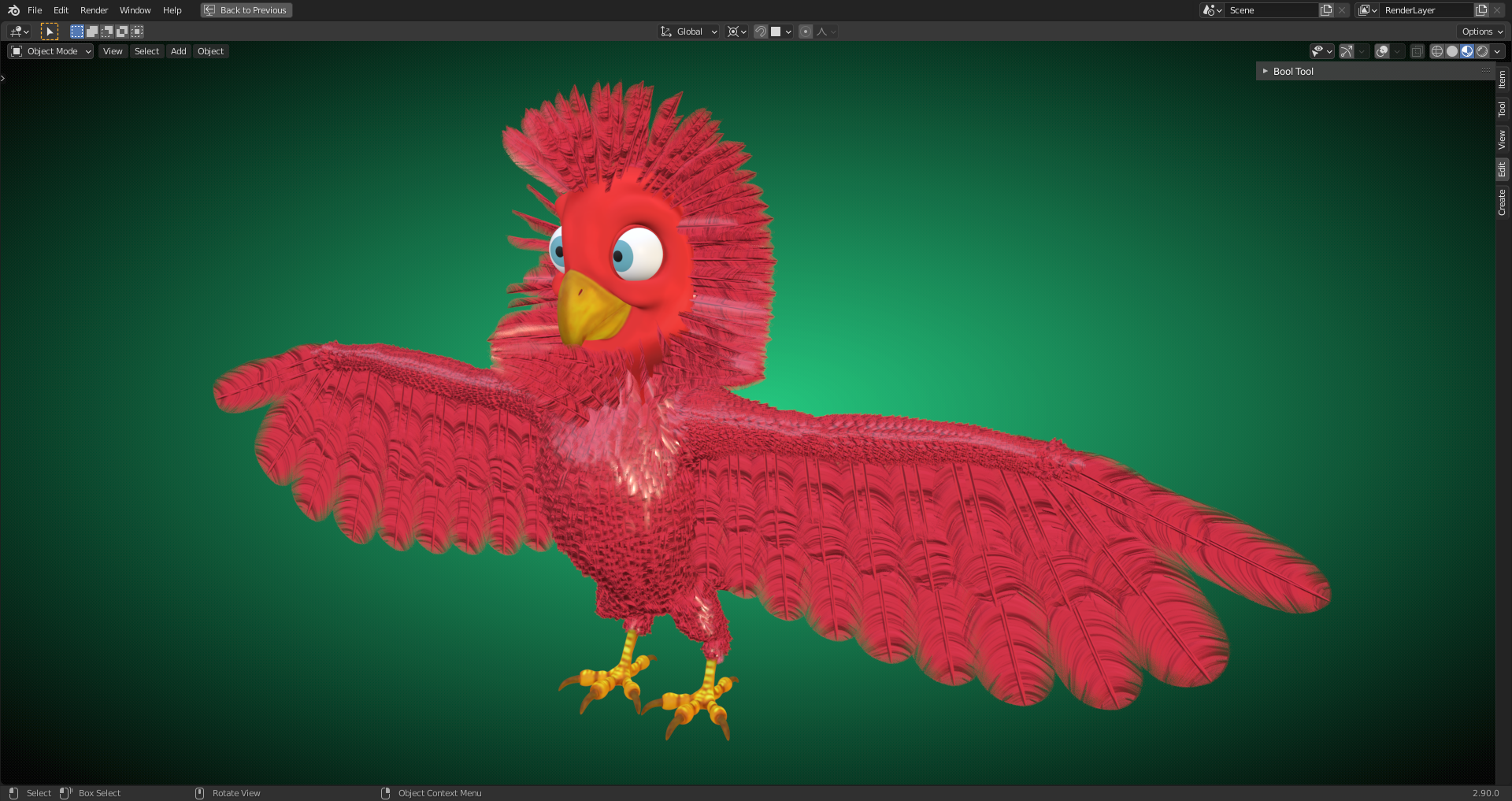

      This is the second layer of “Body Feathers” covering the head controled by a “Hair Density Texture”. A second texture is needed to control the length of the feathers.

        Final Cycles rendering for this lesson with the second layer of “Body Feathers” in place at Piero’s head:
        Render Time:   6 Minutes   4.31 Seconds

          Looking good @duerer! I’ve only got 2 notes:
          1. The wing feathers’ alpha is a bit fuzzy and I can still see the sharp edge of the geometry. I recommend adjusting the contrast of the alpha so the geometry edge is hidden by the “hairy” edge of the feather pattern.
          2. The feather material desaturates the red color so it looks noticeably different from the underlying diffuse texture. The diffuse texture is like a backup in case the viewer sees through the feather groom so it should match a bit better. Admittedly I can’t remember if I address this later in the course but just so you know that it’s best if they’re more consistent visually.
          #60998
          Ingmar Franz
            Thanks @theluthier! The “Alpha Texture” definitively needs to be adjusted in order to avoid the card-like look. And the feathers are still too glossy what makes them distinguishable from the underlying body texture.  Getting this all right is really tricky since there’re many settings and therefore many occasions to do it wrong ๐Ÿ˜‰.
            I’m also not sure whether the “Anisotropic Shader” in Blender 2.90 is working the same way as the one in Blender 2.66.1 since your Piero’s fur feathers are looking much better than my Piero’s fur feathers despite the same settings. Another point is the “Displacement Input Socket” of the “Material Output Node” (grey in Blender 2.661, violet in Blender 2.90; thanks to @spikeyxxx for the hint!) for the modeled feathers which now needs a “Displacement Node” where I plug the “Bump Texture” into the “Height Input”. I’m wondering whether I should use the “Principled Hair Node” for the fur feathers.
            #60999
              I recommend trying an HDRI environment map too. I think reflections of a white / grey world are contributing to the desaturated appearance. A believable HDRI could improve the result pretty quickly without modifying the shaders.
