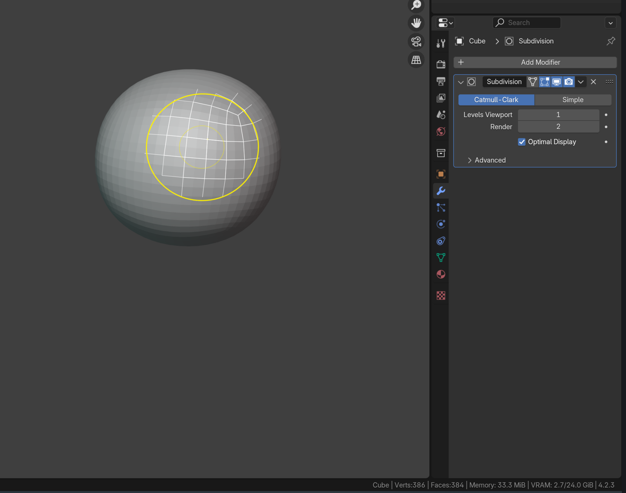

          It is meant to help seeing what you do, when certain Modifiers are Added to the Mesh; if you, for instance Add a Subdivision Surface Modifier, or a Solidify, to the Mesh (seems to work with most, if not all* Modifiers), the Wireframe Preview will be visible.

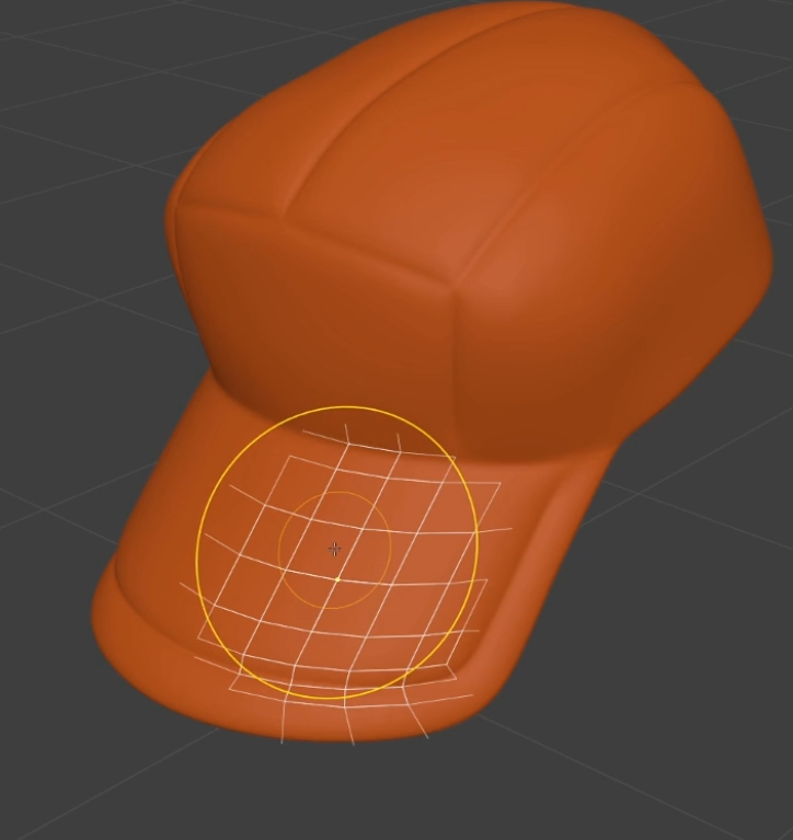

            it doesn’t work Martin. The object has those modifiers. You can’t see the wireframe. I tried with display modifier in edit mode on even
            it is supposed to look like this

              Well, it works for me:
              Without Modifiers, it doesn’t display the Wireframe Preview, but with, it does…
              Stupid question, do you still have Active Vertex enabled?

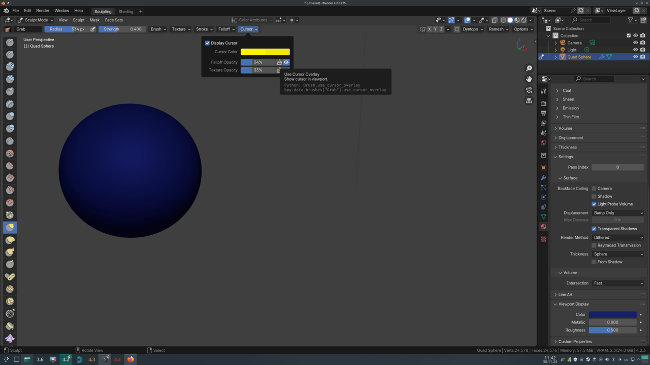

                Also make sure, that the Eye symbol in the Cursor Falloff Opacity is off (not blue as here):

                  sheila5
                    the eye was never on Martin, but learned of it’s existence now, lol ty

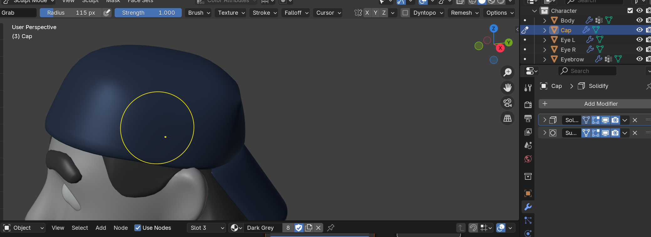

                        sheila5
                          Yes I did Martin and no luck so far.
