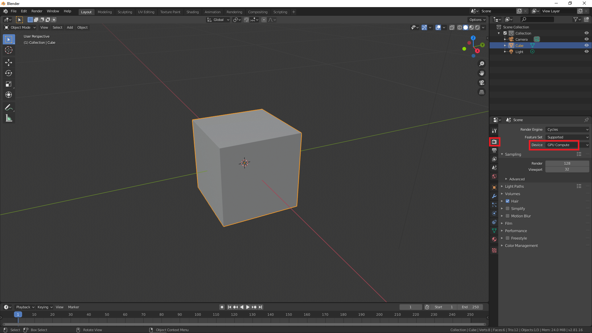

      Hey. I’m just rendering the scene and noticed, that my GPU uses only 5-7% (in the task-manager). To speed the render up I also dropped the framerate to 750×1000 pixel. But I still think, that my CPU could work a little harder. Is there anyting else to enable in the settings?
      I have a RTX 2070 Super (don’t know if there are specific settings). I also installed the latest driver.
      #52830
      Yasser Altamimi
        I don’t know if it is in 2.8 or 2.81 but if you have an RTX GPU you can enable Optix. From my experience that’s gonna help a lot.
        Also don’t forget to enable GPU Compute under the render setting in Cycles.
        #52831
        ndoell
          Thanks for the reply. I use Blender 2.81c (just downloaded it yesterday). When I use Opptix it uses 10-14%. I then tried it with Eevee and got around 30%.
          Since my graphics card does not have any problems with games I assume this scene is just to simple 😀
