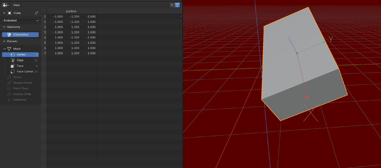

        The Mesh Data is a list of the Vertices and their Positions (and other Attributes, but that’s not important now) (and how they are connected by Edges and Faces).
        If you Move an Object (in Object Mode), you Move the Coordinate System, the Vertices don’t change their Position in the Object’s Coordinate System.
        Same for Rotating and Scaling.
        When you are in Edit Mode, you change the Positions of the Vertices, so the list gets updated.
        A Linked Duplicate, uses the same list as the Original Object, but in its own Coordinate System.
        A ‘normal’ Duplicate uses a copy of that list, so it can be Edited without changing the original Object’s list.

            Correct me if I’m wrong but from my understanding, an Object has two systems, one being called the Object Coordinate System which is independent to the object and the other being the Position of Vertices which remembers the position of all vertices in all 3 axes.
            When a Linked Duplicate is formed, if the positions of any vertices is moved (done in Edit Mode), then the changes apply to the Original Object as they share the same datablock. However, if the position / scale / orientation of any of the two objects is changed, it does not affect the other block as it used the Object Coordinate System.
            I have a question regarding this. When an object is changed using the Object Coordination System, the vertices of the object do move in 3-D space. However, it doesn’t affect the linked object. In what relation does the linked object get affected. Is it only when changes are made in Edit Mode or is it related to the Object Origin.
            #97080
              When you have two linked objects, changes are propagated only what you do in edit mode, so inside the briefcase. At the object mode level it doesn’t really matter when they are linked. Each object at the object mode level has its own personal coordinate system which the other object doesn’t share.
              So in the sense of the briefcase analogy, you have two briefcases and they both magically have the same set of closes inside them. Say there’s a red pant inside one and the same red pant inside the other. If I rip a piece out of the red pant in one briefcase, the other red pant will be ripped as well. But each briefcase can be placed and moved in the room wherever and it doesn’t affect the clothes inside. I can take one brief case and put it in the table and the other in the bed. They both have the same stuff inside but in the outside they can do and be wherever.
