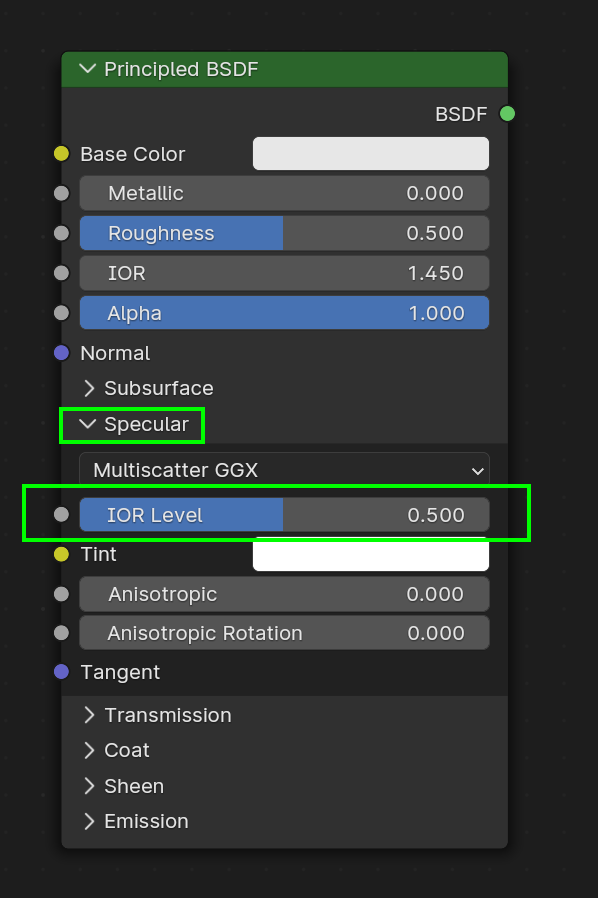

Dwayne is absolutely right. A lot of users don’t know what this Specular slider does and to make it more clear, they Renamed it to IOR Level in the new Principled (Blender 4.0):

No, there is a difference! Like Omar alluded to, the specularity controls how much light gets reflected in total, while the glossiness controls how sharp or soft that reflection is. A diffuse material can still be fully reflective – it’s just that the reflections aren’t very sharp. Turn the Glossy shader’s roughness all the way up to 1 to see what I mean. It’s not reflecting any less light, it’s just reflecting it differently. Martin is also helpful in pointing out that Specularity will be renamed to IOR Level in the next version of Blender.
