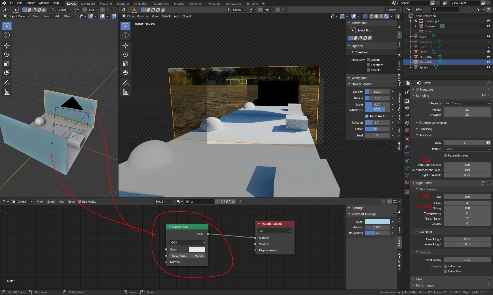

      Hi, I have 2 planes facing eachother with a pure glossy material, and object between.
      I wan to create the infinite Mirror effect, where u can see the Mirror in the Mirror and so on.
      Set High lightbounces and even minimum bounces, but it reduces glossybounces to like 4 or 5.
      Any advice to fix this? Any hidden setting?
      Solved: found that in the render properites i had simplify activated and Maximum AO Bounces set to 2, which will reduce all indirect bounces to 2.

        That is strange…works for me:
        Could you provide a link to your .blend file? (via Dropbox or Google Drive or other)
        #61432
        Tobias Schmid
          just got it fixed, got simplyfy activated.
          #61433
            Ah, right 🙂 didn’t think of that..(have never used that myself.)
