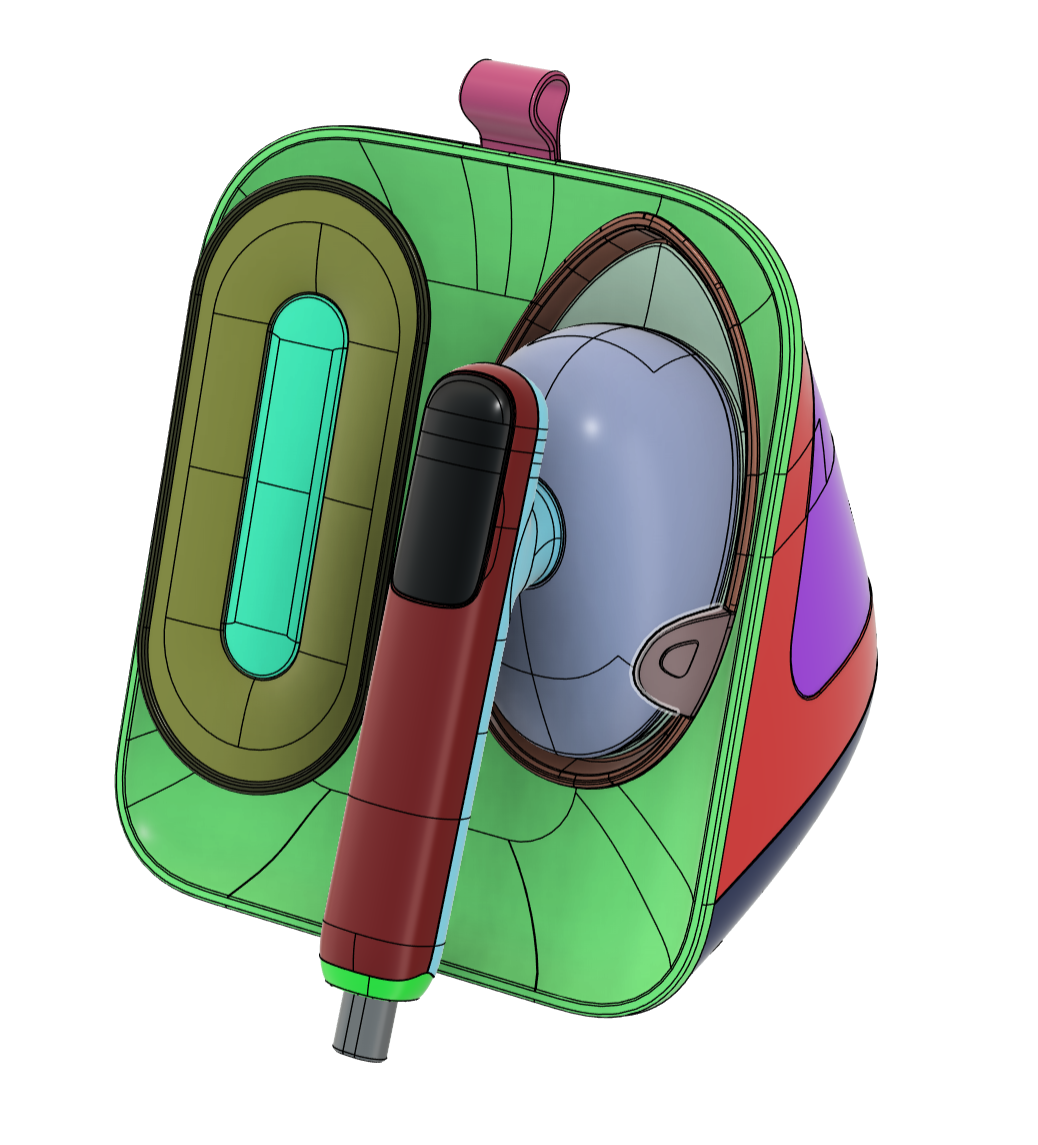

      I have a model in fusion 360, I assigned the different parts of the model different colored materials so that when I export it as an obj, I can open it in blender and then separate the parts by different materials. Here’s the model in Fusion with different colored materials to separate the different parts.

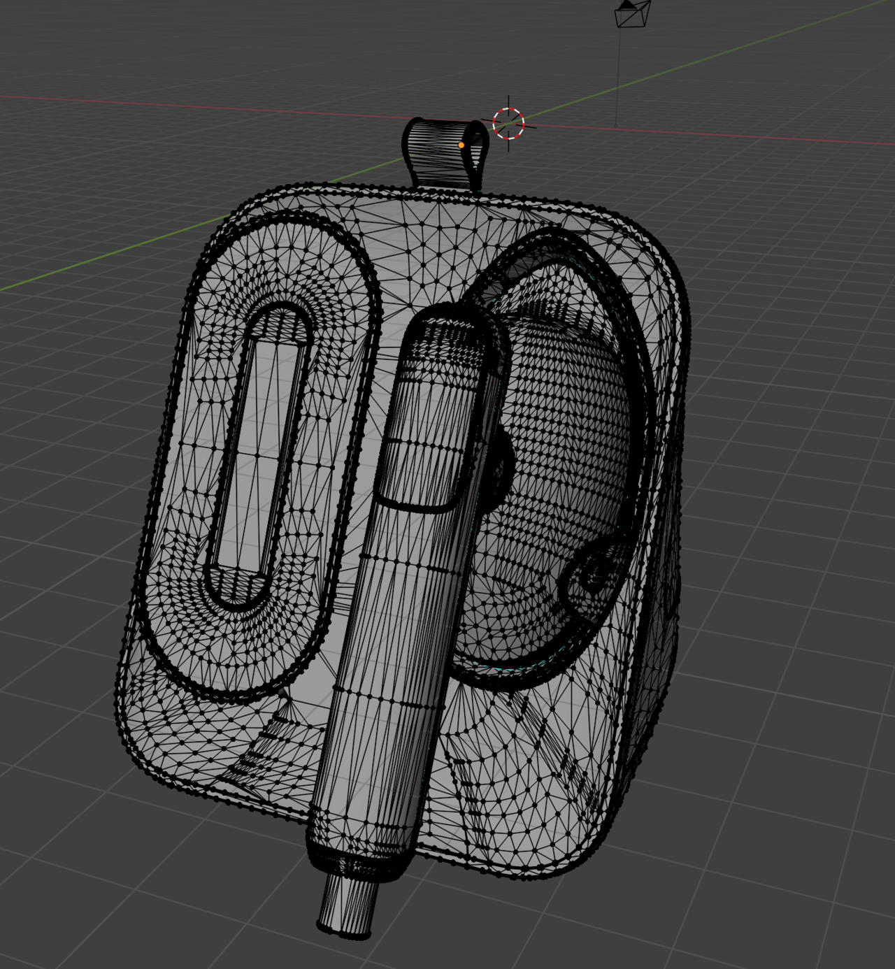

      Here’s what the model looks like in blender after being separated by material

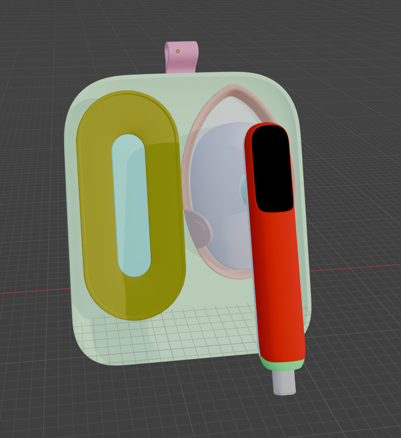

      I then start assigning materials to the model in blender so that I can render it.

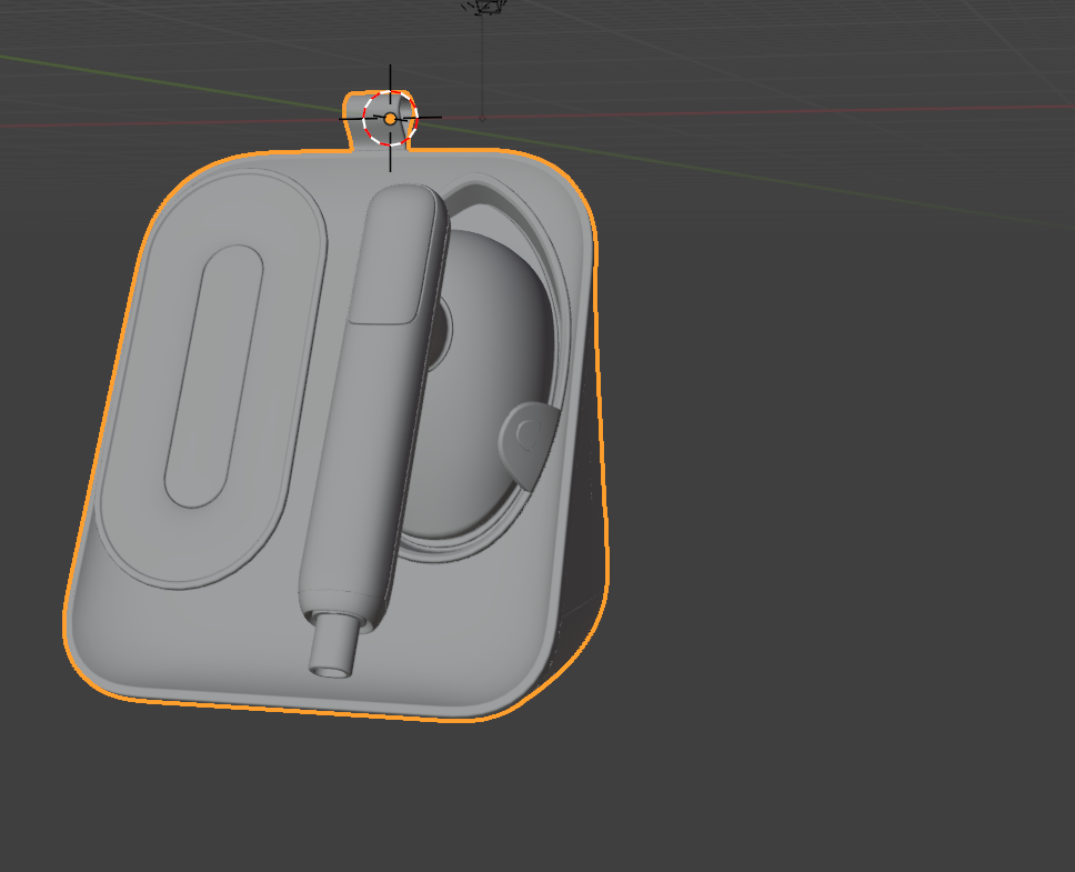

      My issue is, I assigned all these materials to the model but I realized I need to make a small update to it. When I was assigning materials to the different parts back in fusion, I missed one. I went back and saved the updated fusion obj and then imported it into blender again.
      I thought i would be able to simply copy or link the materials from my old obj to the new one but whenever I try, it just makes both models the same material all over. I don’t want to go through and re assign all the materials to the different parts again, hoping there’s a quicker way!

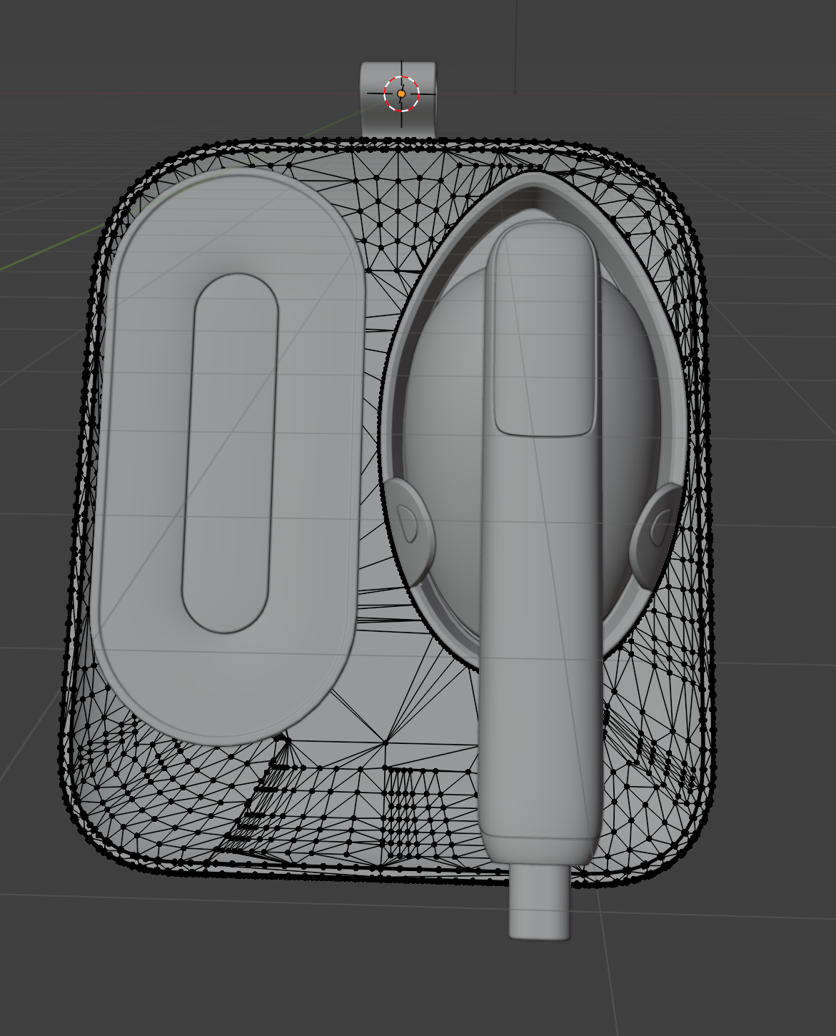

                      Martin, I suppose the geometry in this model isn’t too messy. When I get the files, they are always solidwork files. Hence why I use Fusion 360 to export the file as an OBJ so I may import it to blender. This model’s mesh is pretty good, some solidwork files I get…the mesh is a mess haha
                      But I only assign materials to the different parts in Fusion so that I can separate by materials in Blender. When I assign materials in fusion, I simply assign everything as plastic and change the color, so that parts I want together as one part will all be the same color. For example, if I do not assign materials in fusion, it will import into blender as all on piece like this.
                      It would be a nightmare to try and select all the mesh and separate all the different parts out by selection on this thing
                      I could separate by loose parts, but sometimes it separates things into too many little pieces. I could join them together in blender but that still takes a little more time then me assigning materials in Fusion and then separating them by material in blender.
