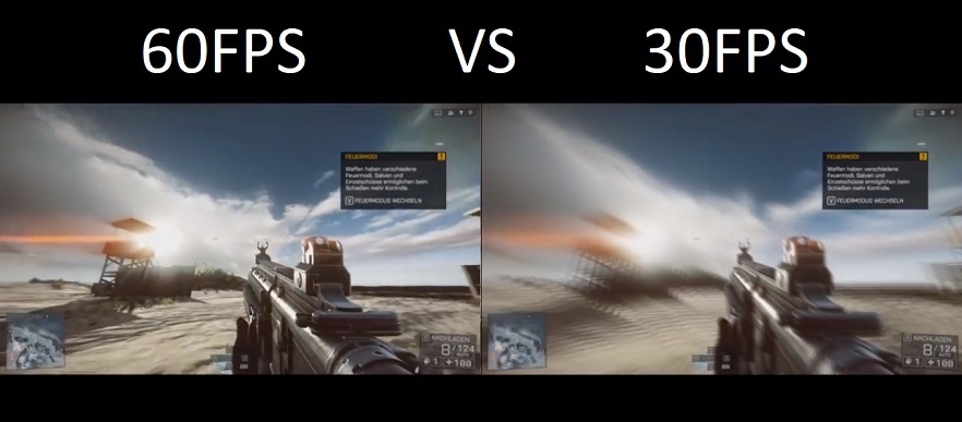

          I think the frame rate is all about perception of movement. The 24fps, 30fps or 60 fps are just standards that have been set throughout the years, I think. At 60 frames, or 60 consecutive pictures in one second, there is a lot more information in there to perceive the movements better. You’ve probably seen gifs like this one FPS GIF, where you see the difference on how your eye can tell there is more spacing in between the movement in the 24fps one and in the 60fps it looks much more smooth.

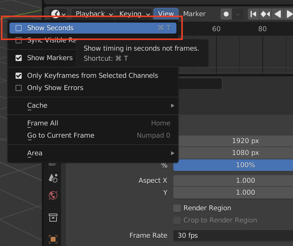

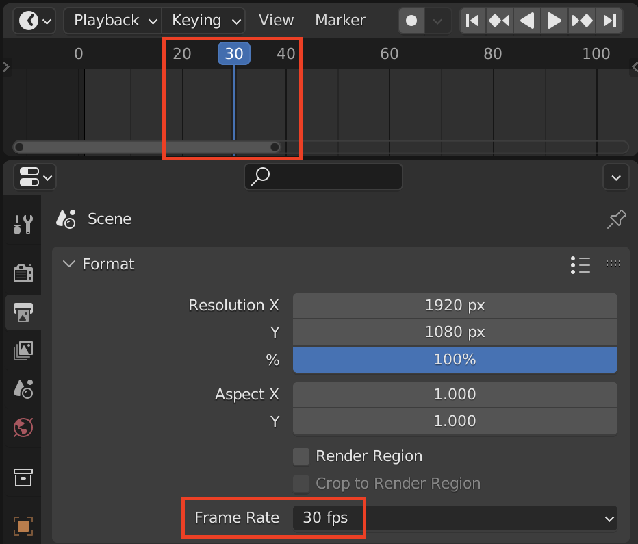

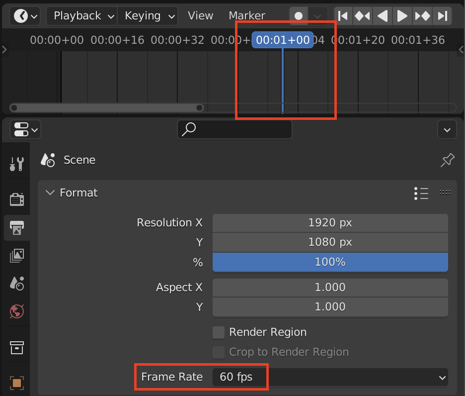

              Ok, check this out… if you set Blender to run at 30fps and you put the scrubber at frame 30, it should be one second, right?
              So you change the setting for the timeline to show not frames but time…

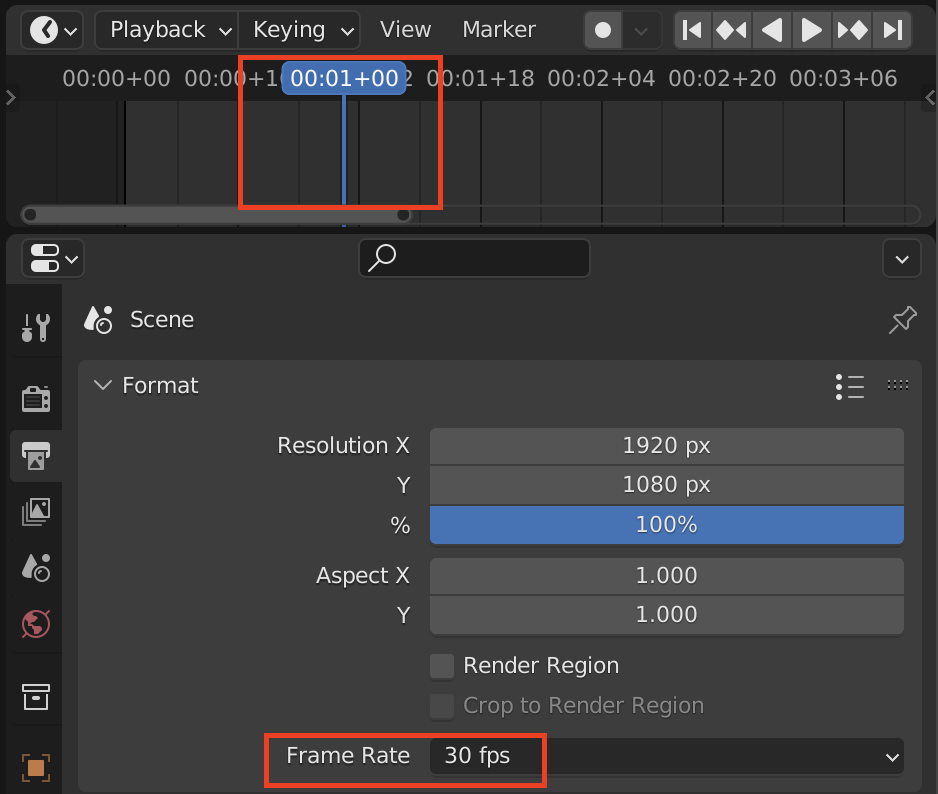

              Then at the 30 frame mark it’ll show 1 second, being at 30fps…

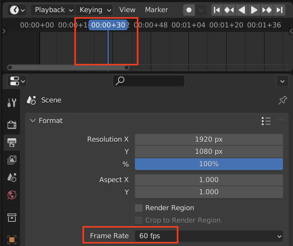

              If you leave the scrubber there and you change the Frame Rate to 60, remember the scrubber is resting at frame 30… now Blender set at 60 frames, the time should read half a second, and it does as you can see here….

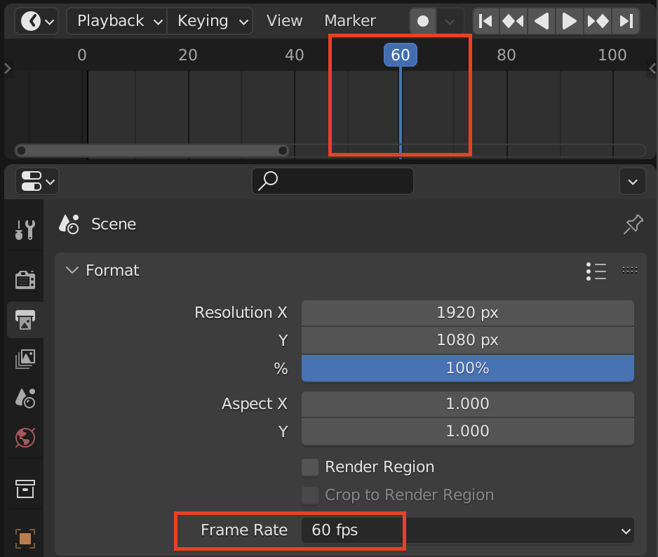

              Now if you want to go to 1 second, you’re going to have to go to frame 60 for it to show 1 second, and it does…
              Changing back to show frames now, it is at frame 60…
              So both in 30 frames and 60 frames, you have 1 second of animation. For 60 frames you had to go double as far in the time line, but it was still one second. If you hit play at 30fps, the scrubber will reach frame 30 in one second, if you hit play at 60fps, the scrubber will reach frame 60 in one second, but it’ll just have to get there faster, because now it has 30 extra frames it has to travel.
              So probably what you have been experiencing is that you are rendering at 30 frames and when opening your 30fps render export, Blender is set  to 60fps and it has to re-interpret, or maybe vice verse, you have been rendering at 60 frames but then when importing back into Blender, is set to 30fps and it has to re-interpret your 60fps render. That’s mostly when that out of wack time happens. In other words, if you exported in 30fps you have to open it with your software set to 30fps and of course, if you exported in 60fps you have to open it with your software set to 60fps.
