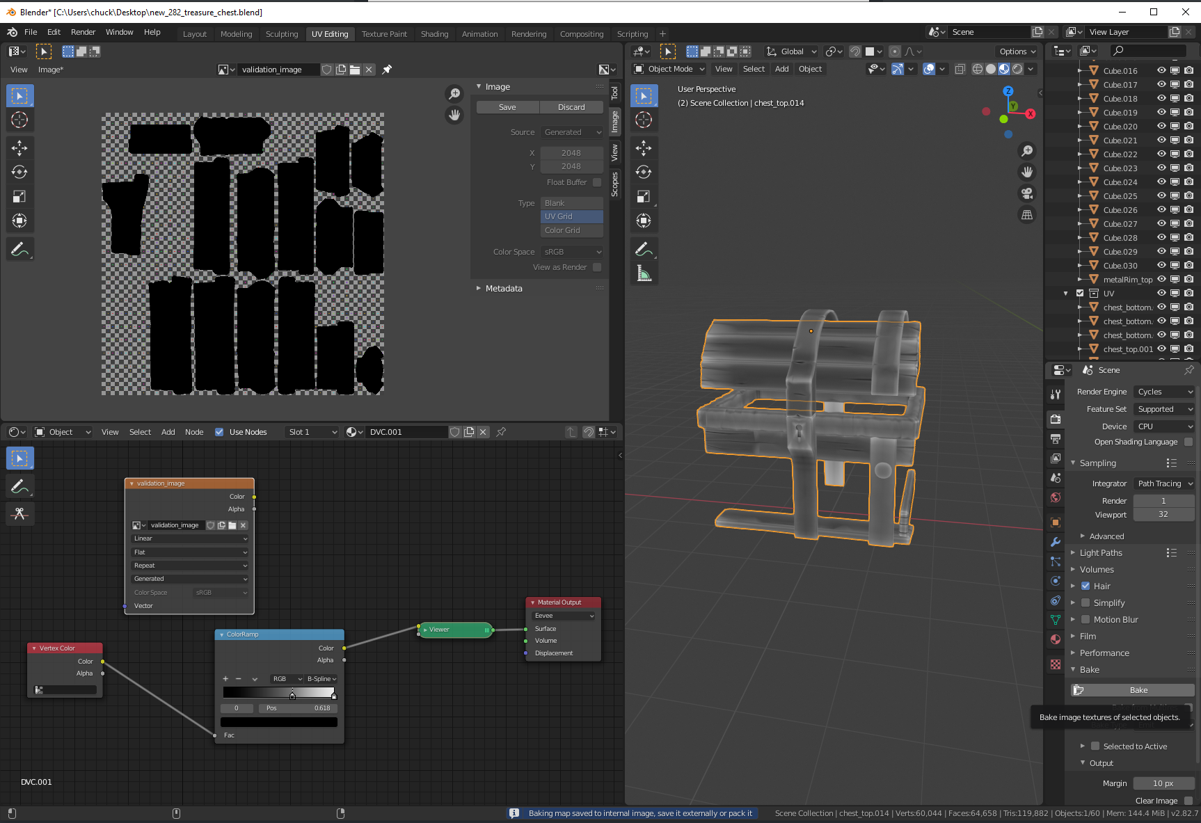

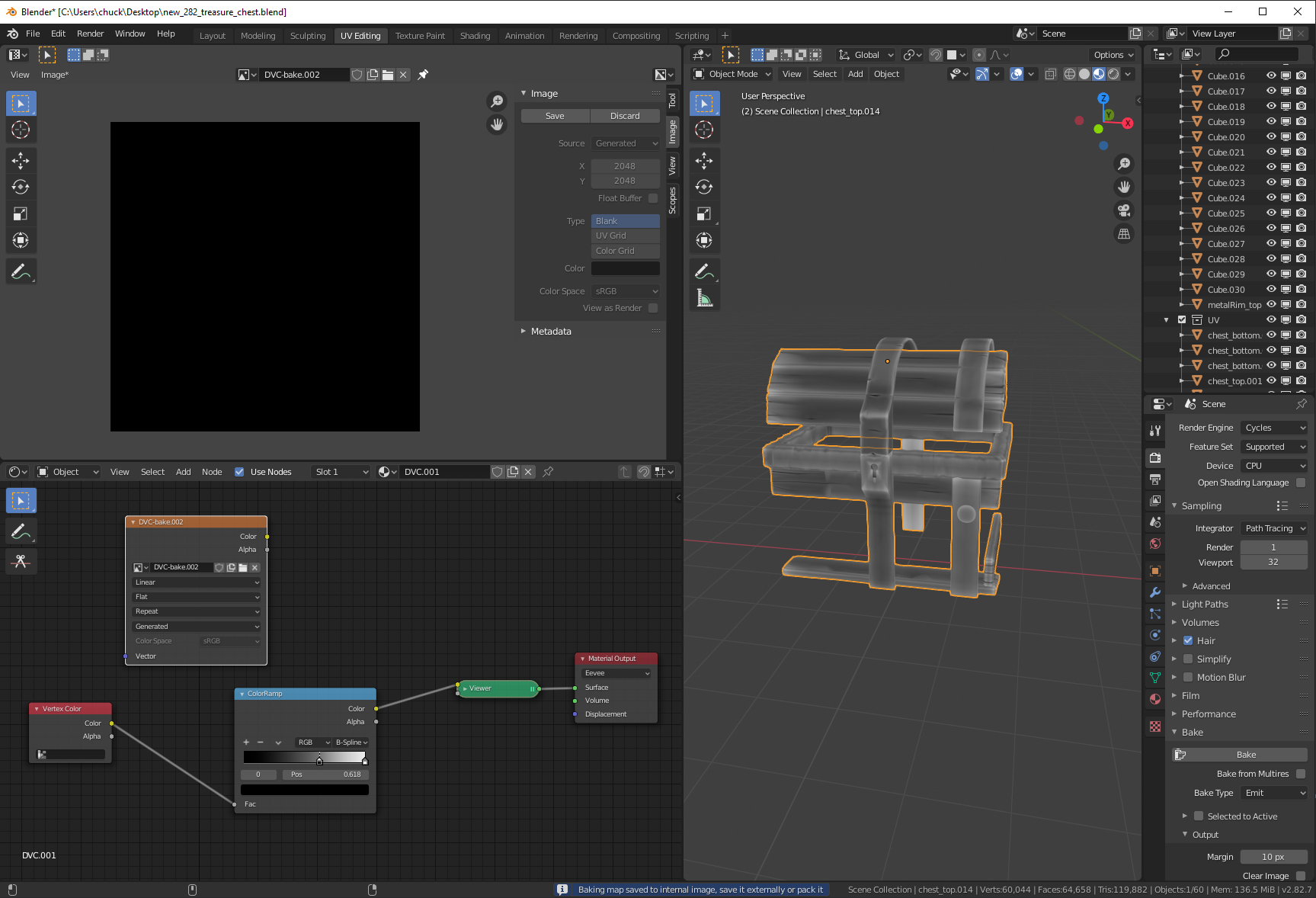

      I’m taking a second pass through the Treasure Chest course, using Blender 2.82 (sub 7) and I’m hitting a snag on the 10th lesson.  Everything has been going pretty well, despite my novice skill level, but at the point where I need to create the dirty vertex (DVC) materials, anytime I try to bake the texture I get a completely black image.
      I’ve changed the image type just to validate that something is being correctly baked based on the UV maps, and they are, but it always generates the planks as completely black.  I’ll post a few screenshots below.
      For what it’s worth, I tried doing some digging around search results, but everything seems to reference missing light objects.  I’ve tried adding one just in case but got no results either.
      Here are the results:
      Here’s an image where I did an Alpha on a UV Grid, in an attempt to show that the UV map exists and the object is indeed being baked.

      #55685
        Your Vertex Color Node (in the Shader Editor) is ’empty’!
        You need to fill in the field with the name of the vertex color (it’s probably just Col).

          Hey @spikeyxxx , thanks for taking a look!  I added the name of the vertex color which was indeed Col (the only option) and tried another bake, but no luck — still comes out all black.

                    Hi, I missed this, but in the Material Output Node you have it set to Eevee. Change that to All. Baking is done in Cycles, so if the material is Eevee only it will be black.
                    #55692
                    amazinglarry4tw
                      I knew it would be something stupid, haha… I had looked into that briefly last night, but turned away as soon as it turned my object purple in Object Mode – I automatically assumed it was incorrect.  Thanks again for your help!  I feel like I can’t continue through projects (especially tutorials) when I hit a snag like that.
