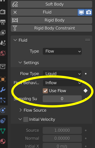

          …or animate the Use Flow Property of the gun:
          and keep the fluid sim running…
          #71132
          Shannon
            Thanks so much spikey!  I animated both values and it worked a treat.  As a beginner in animation I aways forget you can animate the setting in the side panel.
