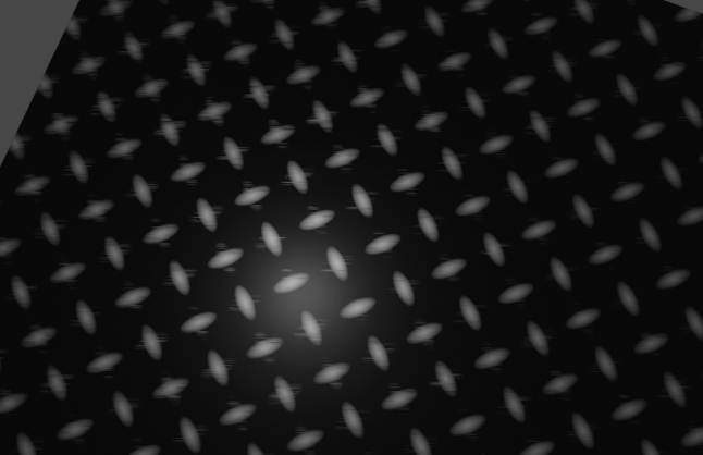

      Interesting tutorial, great to see more tutorials pop up that already work in 2.8. Good to know you can create material setups like this too even in Blender, and not just in Substance Designer etc. Just a question though, when I look around in the viewport using EeVee I get this flickering effect. It’s not showing up in Cycles.
      EDIT
      I fixed it by setting the Z value in the last two ‘Combine XYZ’ nodes to 0. I’ll have to rewatch the video to see if I went wrong somewhere

        Yes, I can observe the flickering too in some cases. As far as I know eevee is still struggling a bit with bump map. Ethan explains in a bit more in details here. The maths nodes also may make it harder for eevee to compute the whole shader, perhaps.
        I tried your trick with the Z axis and could still observe some artifacts in the viewport unfortunately. Hopefully this will be fixed in future releases !

              I had the same flickering problem in 2.82. I set the z scale value to zero in the mapping node and the problem went away.
