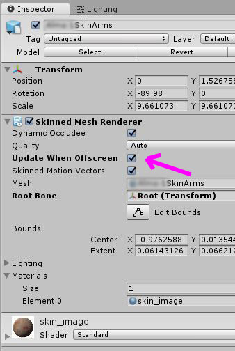

      Eventually I tried ticking “Update when offscreen” on the arms, and arms/hands no longer disappear – problem solved. Although I don’t really understand why it happened. Character has several separate meshes parented to one armature, so maybe it confused Unity. I tried attaching a sphere to a hand bone and it didn’t disappear (until I zoomed the camera past it).

        It’s not that the textures are disappearing, it’s that the mesh isn’t being rendered when offscreen. It’s kind of a weird bug and it’s due to the Animator. On the Animator component you can set it render at all times or only render when it’s visible on screen. This doesn’t always work though so usually I would recommend changing it to always update.
        I’m not sure where you updated the “Update when Offscreen” settings, but this probably does the same thing.

          The one which seemed to work was on the skin mesh itself, as follows:

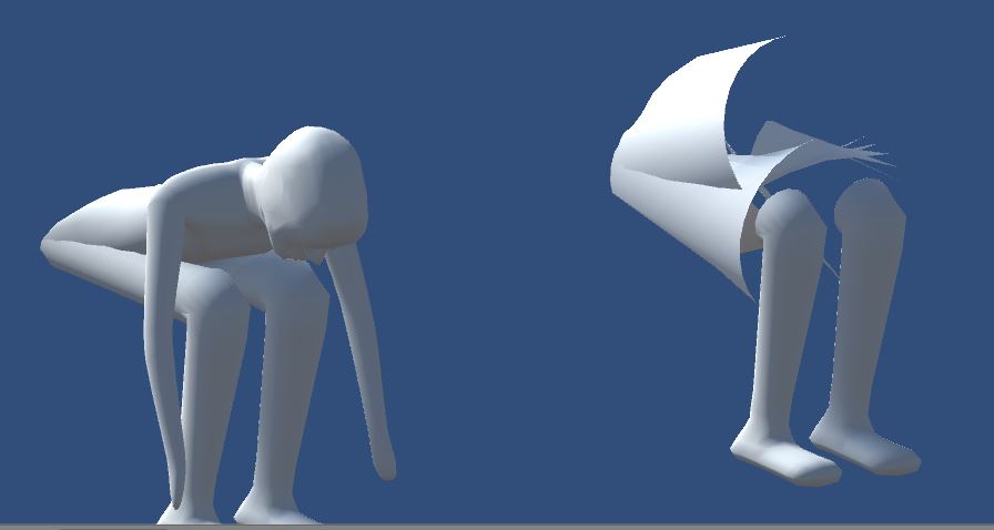

                @jgonzalez I did another test (with a simplified model) and proved the source of the problem. It is caused by having separate skin meshes applied to a single armature rather than one continuous skin. This was needed in my case, although hard to explain. When zooming in (by any method) in game mode, the skin sections stop rendering from the top down. (the “update when offscreen” is a successful workaround)
