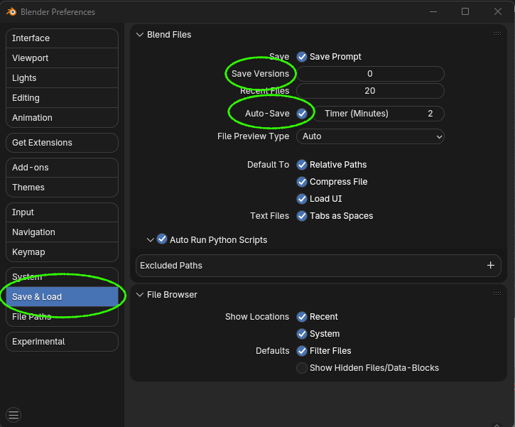

In the preferences, select save and load, set the save versions to 0 to not save any.
I have mine set to 0 and the auto-save set to 2 minutes. I find the auto-save gives me plenty of backup while I am working, saving incrementally I have no use for Blend1 files.
