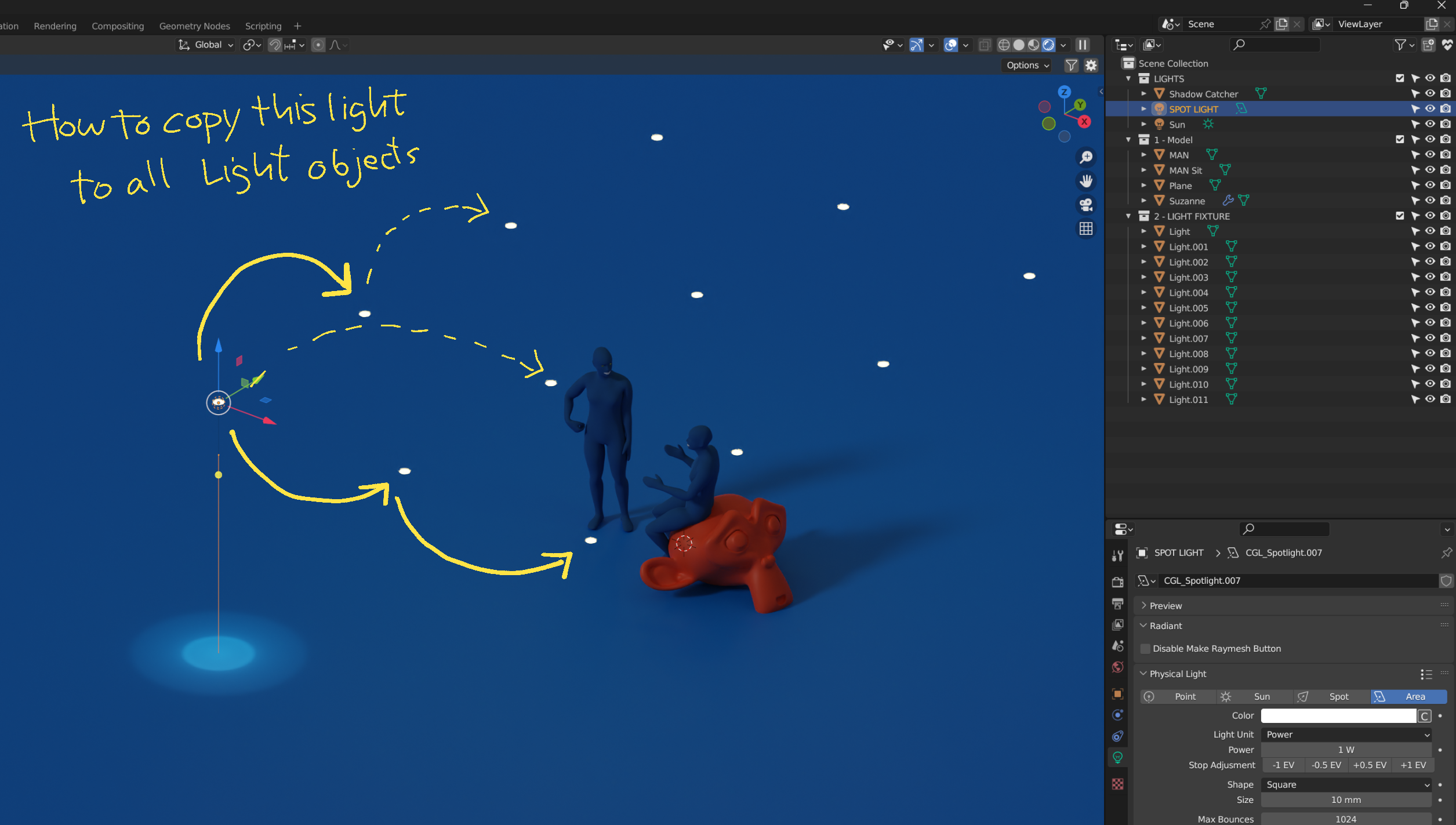

      Is it possible to link or attach a light source to a key object, so that all other linked objects automatically have the same light?
      Currently, I have multiple instances of the same light fixture mesh in my scene, and I have to manually copy and paste the light source to each one.
      I’m looking for a more efficient way to add light to a key object and have it update all linked objects, similar to how linked mesh data is edited.

        Put everything in a collection and and instead of linked object use collection instances. Shift+a->collection instance->select your collection.

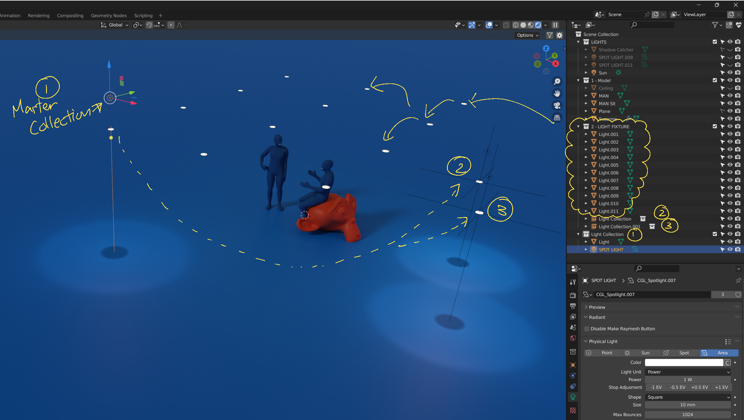

          1.  If I first create a collection of the mesh and light, then copy and move it throughout the scene,
          it works very well. Editing the master collection updates all linked collections accordingly.
          2. However, in many cases, I have the light mesh in the scene before adding the light. Most case like import architecture model to Blender, I will get only imported mesh first.
          Is there a way to replace the existing light mesh with the light collection?

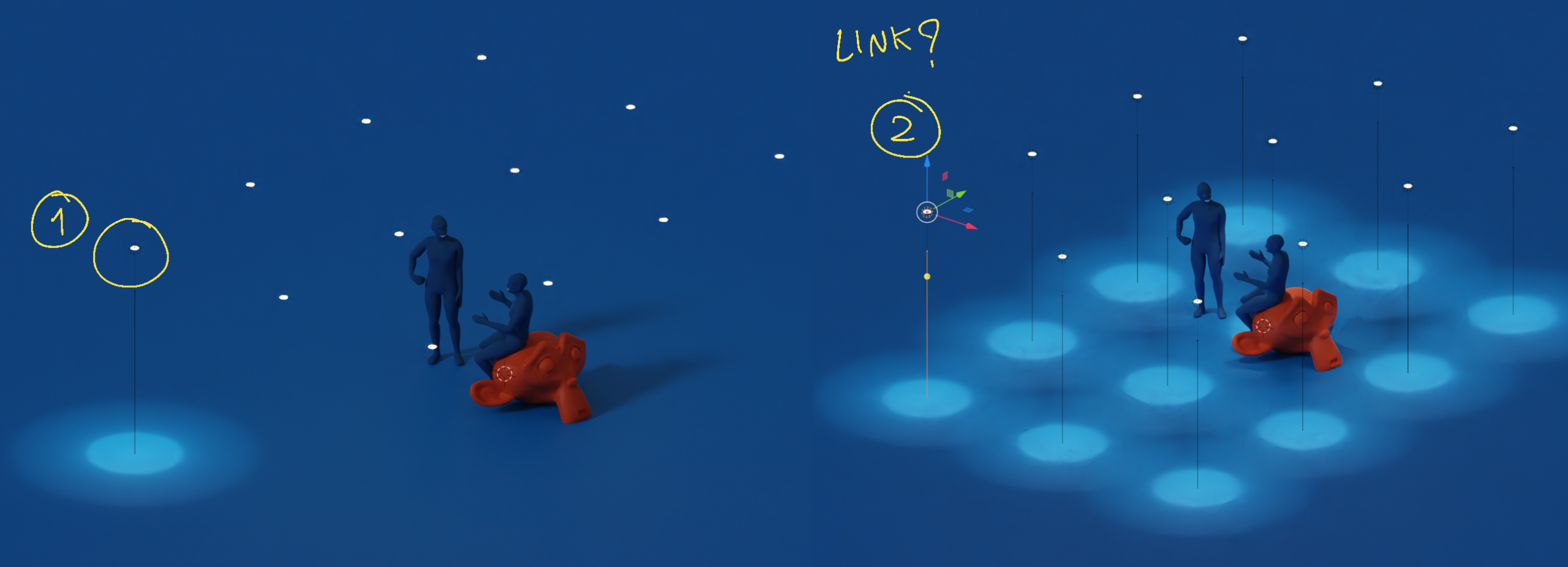

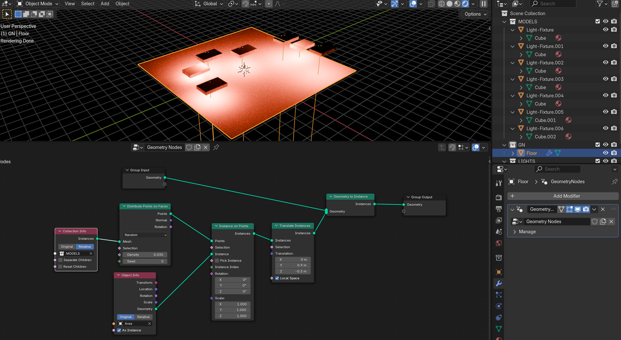

            Hi Kwin,
            Maybe you could use Geometry Nodes for this:
            Don’t do it exactly like this, this is just a quick and dirty Proof of Concept. Works with Linked Duplicates and pure Copies of the Light Fixtures, as you can see.
            To be fair, I don’t understand what you meant in your last comment.

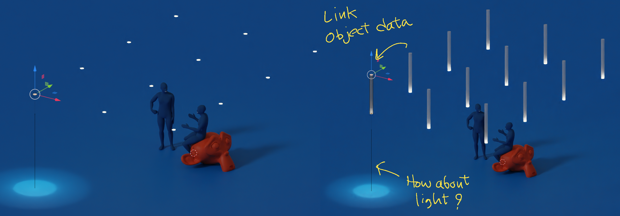

                Hi Martin,
                Thank you for your response. I haven’t learned how to use geometry nodes yet, but I can see that your demo is very useful. I will keep learning to understand how to use them.

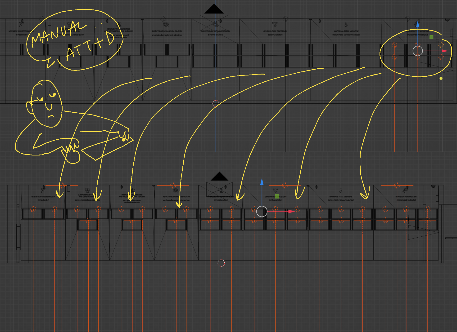

                I hope this sketch helps explain what I’m trying to achieve. I’m looking for a way to replace all “light meshes” with a “light collection” (mesh + light).
                Currently, I manually copy the light to every light mesh location. If I could create an original collection (light + mesh) and have Blender replace all similar meshes in the scene, it would automatically distribute the lights without much effort.
                This is similar to how I change materials in the whole scene using “Shift+Q” to replace them all at once. If I could apply the same concept to meshes, it would be perfect.

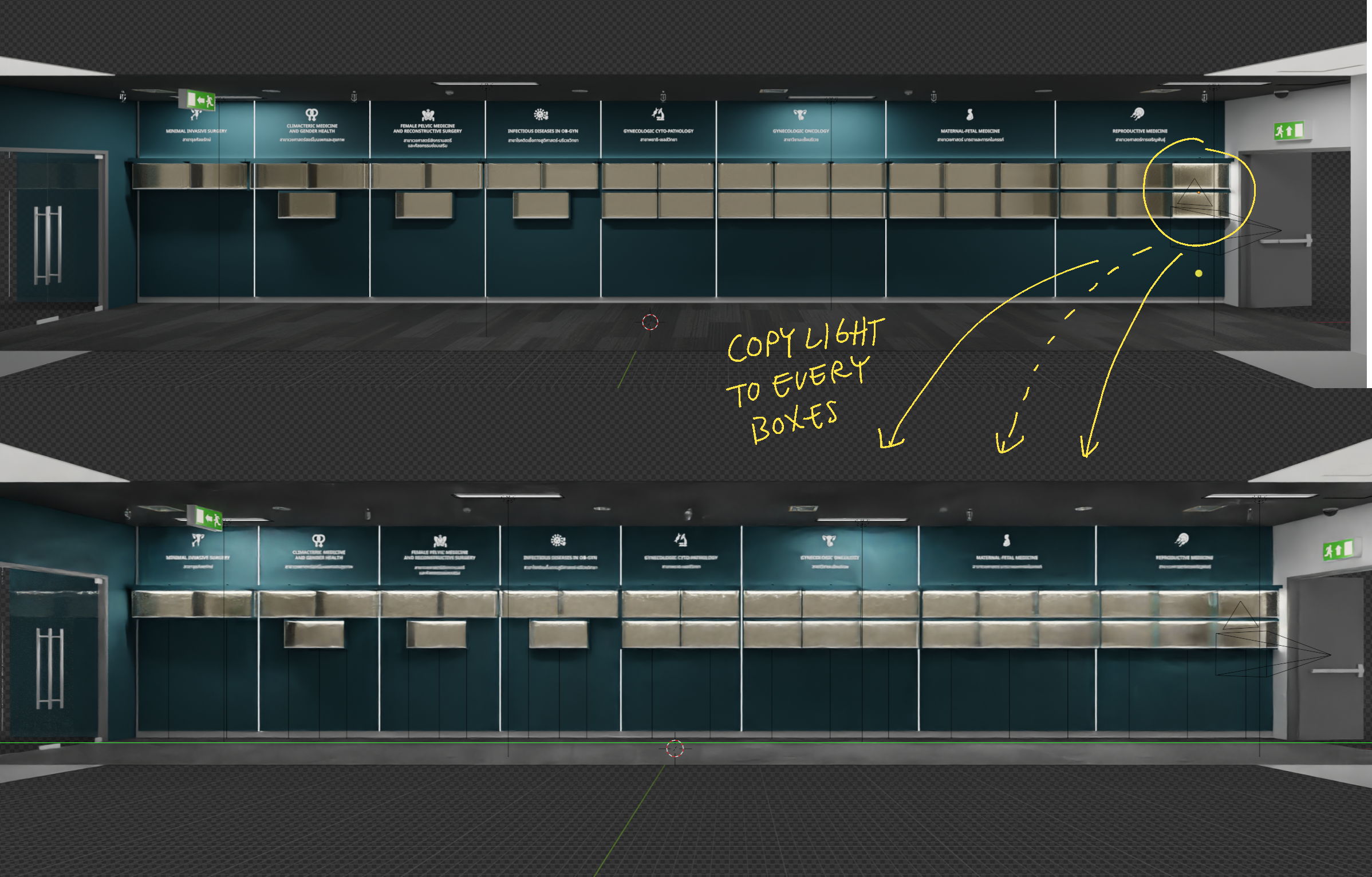

                      Below , here’s a real use case for a project I’m working on: I need to add lights to every display box.
                      My current workflow involves using ALT+D to copy the area light to each target position one by one.
                      While this isn’t too time-consuming for small projects, it becomes challenging and lengthy for projects with lights in faraway locations.
                      This is why I asked my question. If I could assign a light to one original mesh and update the rest of the instances, I could light all targets in one go.
                      It might not be possible at the moment, but I wanted to ask anyway.
