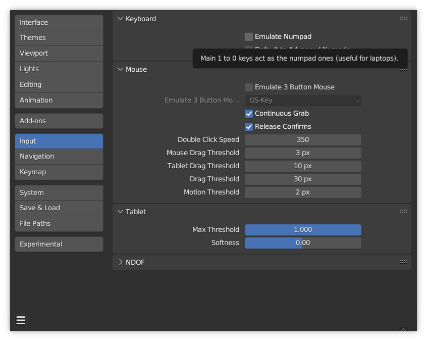

        When you don’t have a Numpad, you can set your Preferences to use Emulate Numpad:

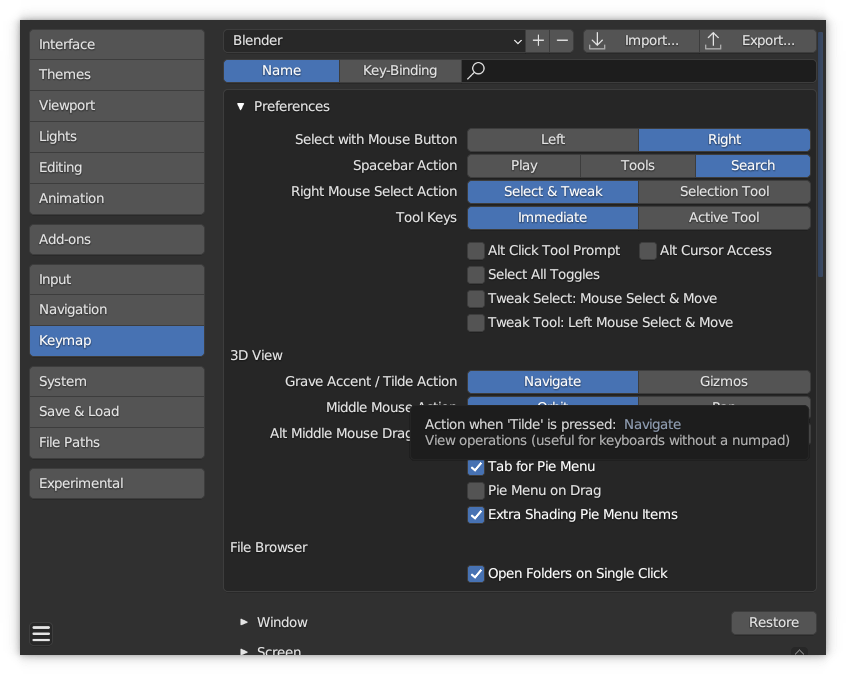

        When you don’t have a Numpad, you can set the tilde action to Navigate to get a Pie Menu for the Views:

              My Emulate numpad is on,and still not working as expected.I edit mode it’s still switching my views instead of alternating between the V,E AND F.
              So I turned off the Emulate numpad option and now it works.
