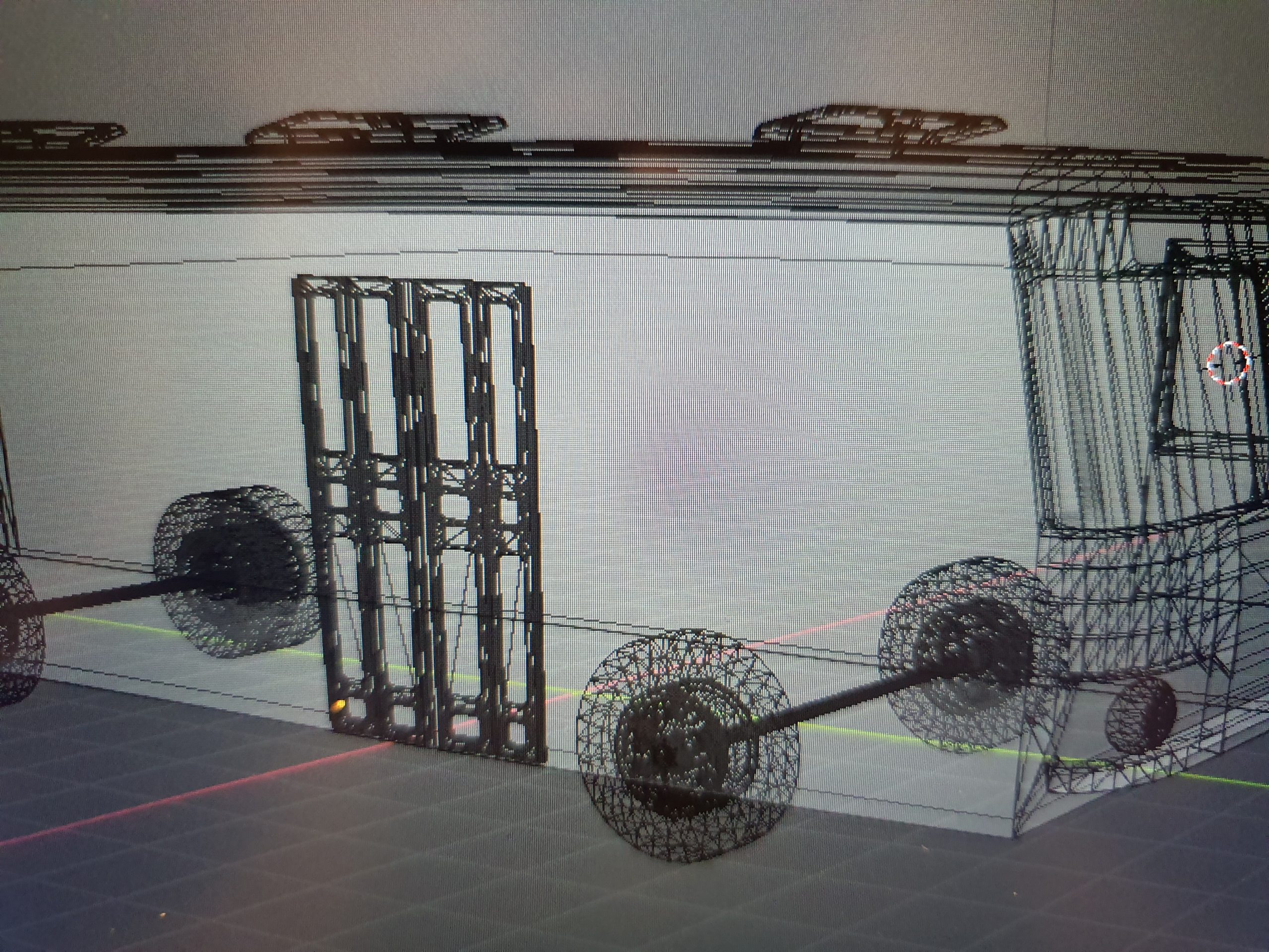

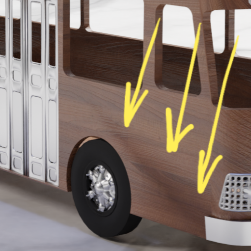

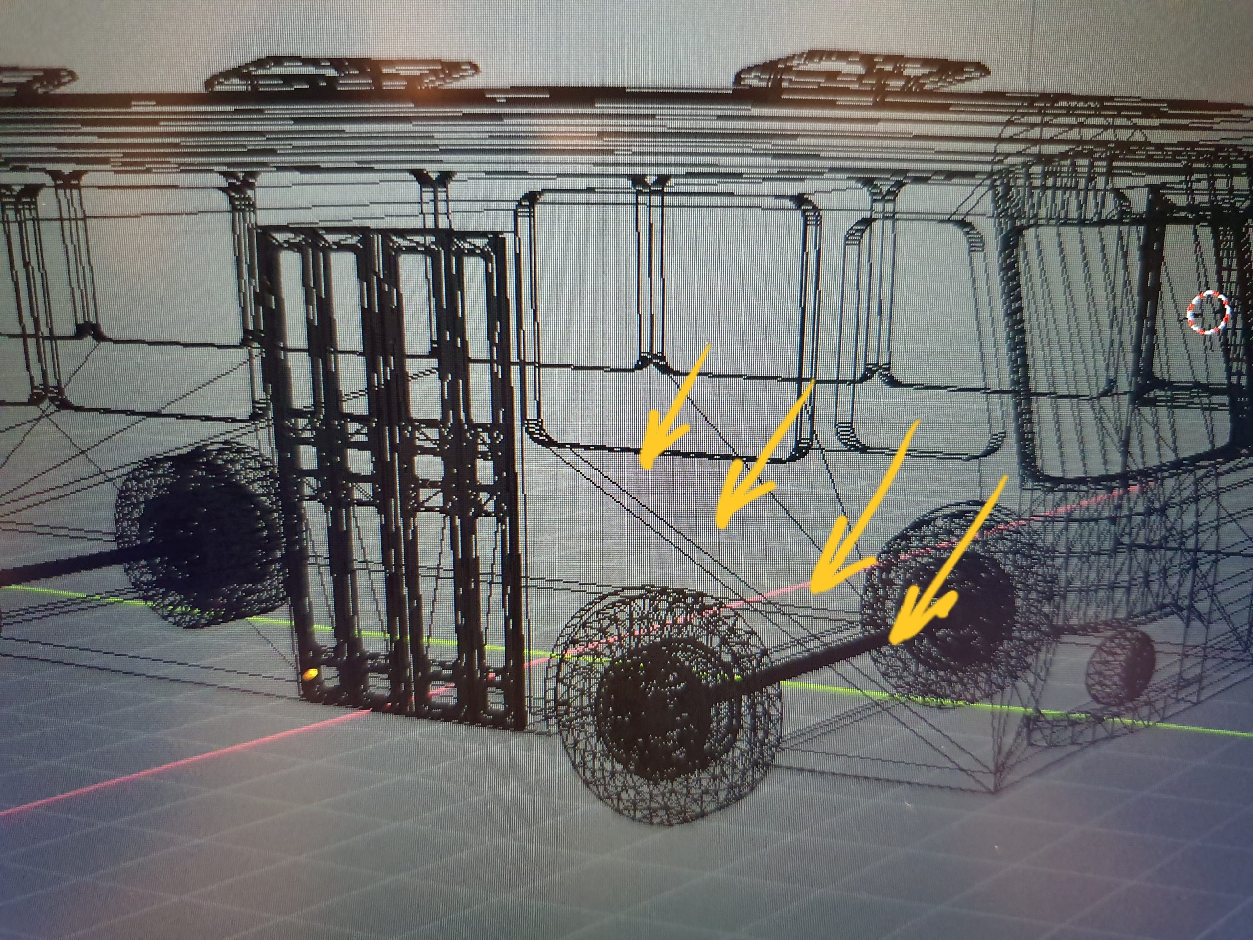

      In wireframe mode some extra lines (edges) are visible and this extra lines are reflected on a render view and make some weird reflexes (blots). In edit mode there are no extra lines.
      Edit mode:
      Wireframe mode:
      Render view:
      This lines are obviously result of adding modifiers (boolean).
      Please help me to get rid off from this unusual creases.
      #53395
        Looks like you’re using smooth shading. In that case try checking Autosmooth:
        Maybe you’ll need to adjust the Angle to get rid of faceting in other places of your mesh, but those edges should no longer affect the shading.
