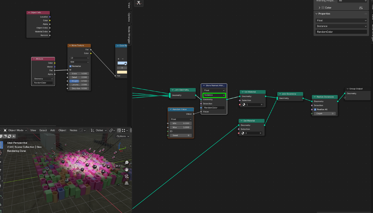

                #97621
                  Hi Christopher,
                  Thanks for the file!
                  Sorry it took me so long.
                  But anyway, the problem is the way the randomization is set up in the Material. That gives a random per Object and after Realize Instances, all are just one Object.
                  There are several ways to go around this, but I think the easiest is to use an Attribute for the randomization. Maybe something like this (I also switched to a 1D Noise Texture because it’s ‘cheaper’):
                  Here is a link to the ‘fixed’ file:
                  https://drive.google.com/file/d/17Yzuj0M_gefK_V7g6B-KxTJb_PCBMkE8/view?usp=sharing
                  #97622
                  Christopher Stevens
                    Martin, thank you so much. I thought it might involve attributes of one sort or another but wasn’t sure of how to actualise that. I truly appreciate your time and expertise in helping me with this. Thank you so much!
