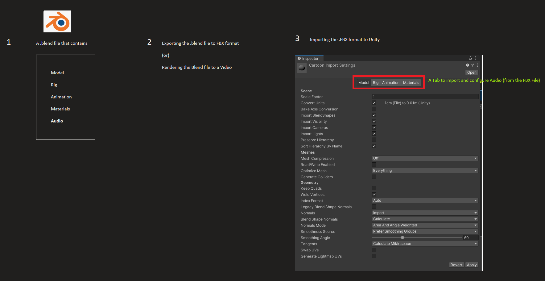

          Thank you @Adrian. I was kind of hoping that there is an Audio tab along with the following Model, Rig, Animation, and Materials Tabs when importing an FBX file that is exported from Blender.
          That way, any Blender animation with an audio track could either be
          • rendered as a Video file from Blender or
          • exported to Unity little to no further configuration

            The image you posted above is of the inspector panel for a model.

              Please allow me to clarify @Adrian. Let’s say I have a Blender file with a model and an audio track (with the model animated to be in lip sync with the audio). I was kind of hoping that when I export this Blender file to FBX format and import to Unity, the audio clip would also be available to be imported and configured within Unity (similar to the other contents of the FBX file like Model, Rig, Animation, Materials like in the snapshot above which Unity recognizes and allows us to configure). That way the same Blender file could either be rendered to a video or exported to Unity without having to do additional steps in Unity for the audio.
              Here is a little schematic for further clarification:
              1. I have .blend file with a Model rigged and animated and with an audio track
              2. I exported the .blend file to FBX format (which would contain the contents of the .blend file)
              3. I import the FBX file to Unity and I expect Unity to recognize the audio in the .FBX file and allow me to readily import the audio as is or allow me to configure it.
              I hope I am able to convey my point across this time. 🙂

                    No, it does not, which is why I posted the question wondering if I am doing something wrong. I would have expected the audio to have been available as well as I don’t see a reason why it can’t be exported from Blender and imported into Unity for ease of use. If time permits, I’d like to dig into the content FBX format (somehow) and see if it includes the audio or not.
