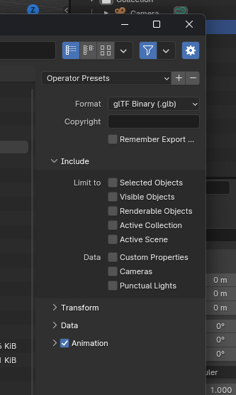

I worked with ThreeJS a few months ago and faced similar problems.
If you go to Export in Blender and the new window appears, there are settings on the right.
You could try to select your object beforehand and then in the settings under “Inlcude” you only select selected objects. Then it will only export the selected objects and their animations.
There is also a setting to export only the scene or only visible objects.
It is also important that the check mark for animations is set at the bottom. It’s best to play with the settings 😉
It also helped me to export the file as GLTF. It is then structured in JSON format and you can view the structure in Notepad to see exactly which objects and actions it has exported. That looks something like this
Then you can also address the actions directly with the respective name
