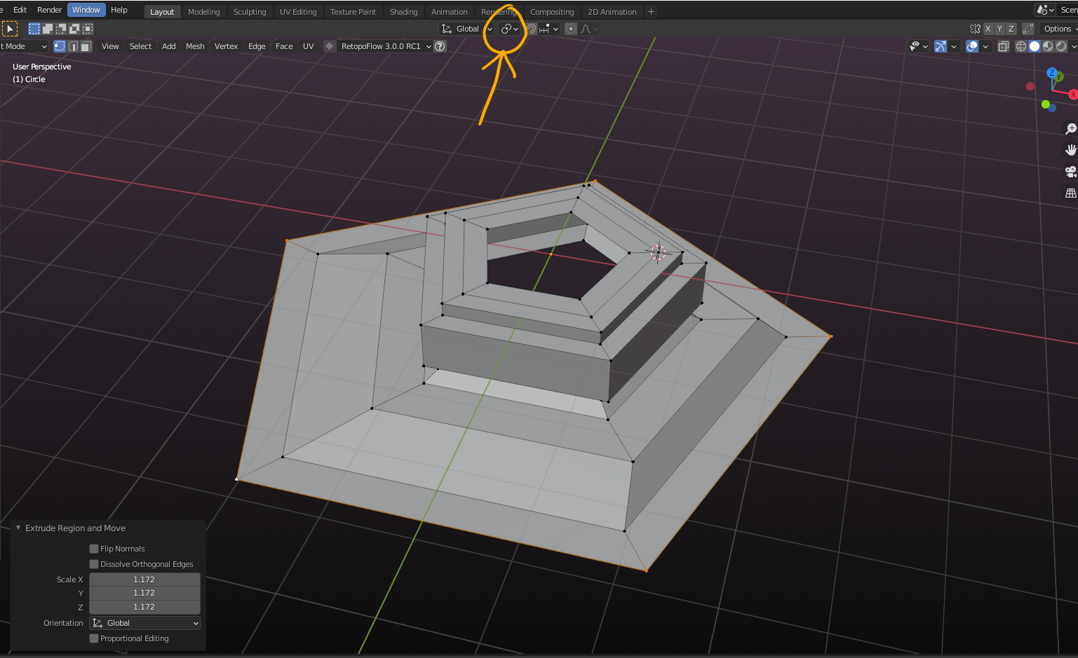

        glowgun
          Everything seems to be oriented around the 3D cursor and when I tried changing the transform pivot point as you’d shown it made it no longer able to be rotated or scaled.
          The transform pivot point was set to “3D Cursor” and I have no idea how it got like that but even after changing it I can’t seem to fix it.
          Thank you for your help though, much appreciated
          In this image I have the crater selected, but it can only be rotated or scaled according to the 3D cursor

          coyo
            In the image you posted the transform pivot point is definitely set to the 3D cursor. It’s possible that in a previous lesson he had you change it for some reason. Sorry, I haven’t done that tutorial but possibly he had you copy and rotate the fins around the 3D cursor? At any rate, the transform pivot point is definitely off somehow.
            If you chose “Median Point” from the dropdown and it disabled rotating and scaling I’m not sure what the issue could be. I’d have to look at the actual blend file if you want to share it.
