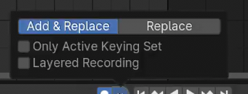

                You are getting the error because the ‘Available’ keying set will only keyframe existing channels.
                I can see, however, in the autokey dropdown that you don’t have “Only Active Keying Set” enabled.
                This is why it is adding the Y loc channel back.
                If you check that one on, it will work exactly like the tutorial.

                  So I submitted the completed exercise, done in 2.82. I get the concept, I still can’t seem to translate it to 4.1 though. I tried clearing the keyframes using the method suggest by Dwane. I have “only Active Keying Set” enabled, I disabled all mods except a couple basic stock ones, and I still get that error when trying to insert keyframes between other keyframes using either “I” or “K’.
