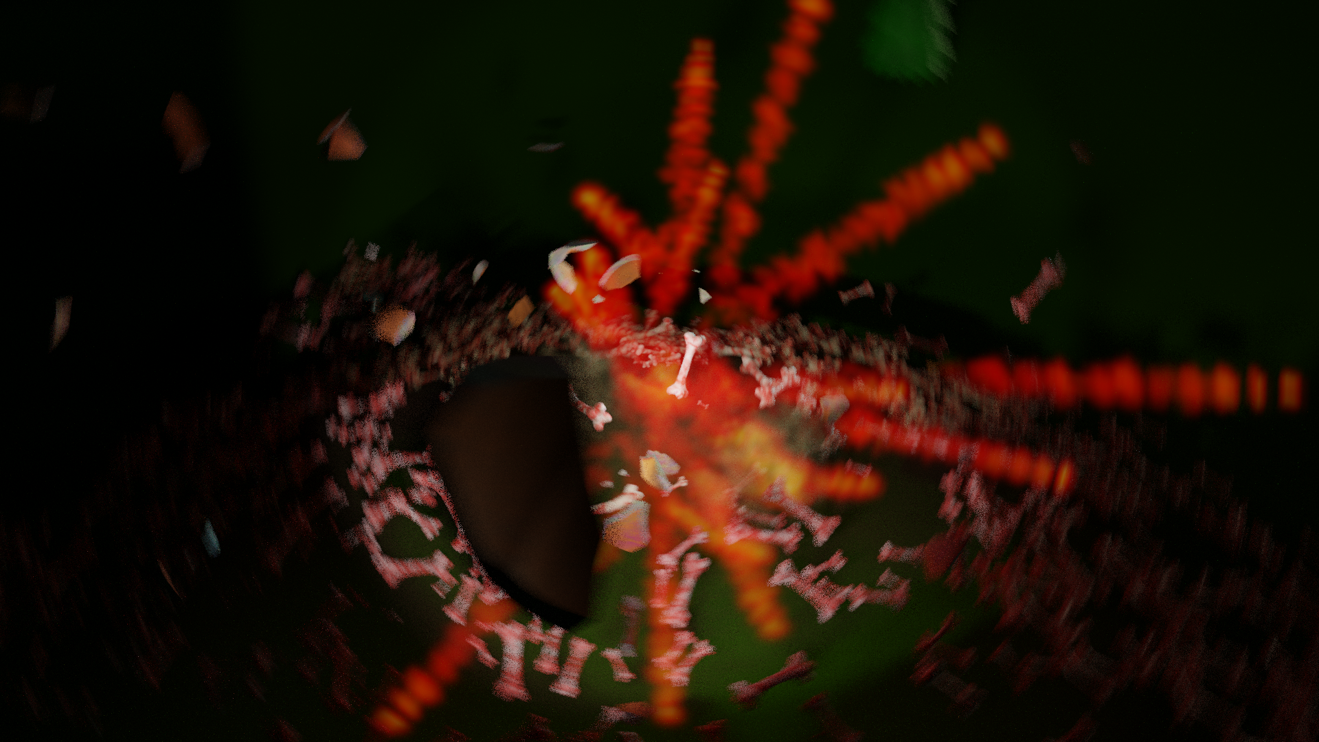

        With four times the resolution for the “Smoke Domain” and more bones being pushed away, I get this result:
        #60570
        Ingmar Franz
          Frame 109 rendered:
          Render Time: 21 Minutes 17.08 Seconds.
          Still too much “Motion Blur”.

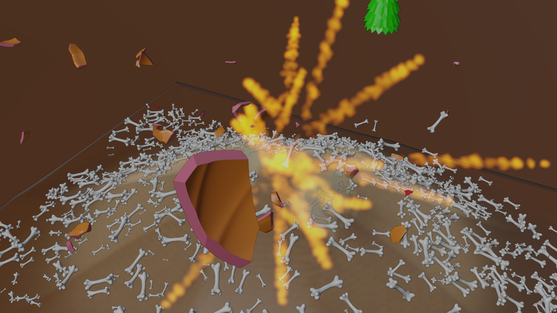

          And as “Viewport Rendering”:

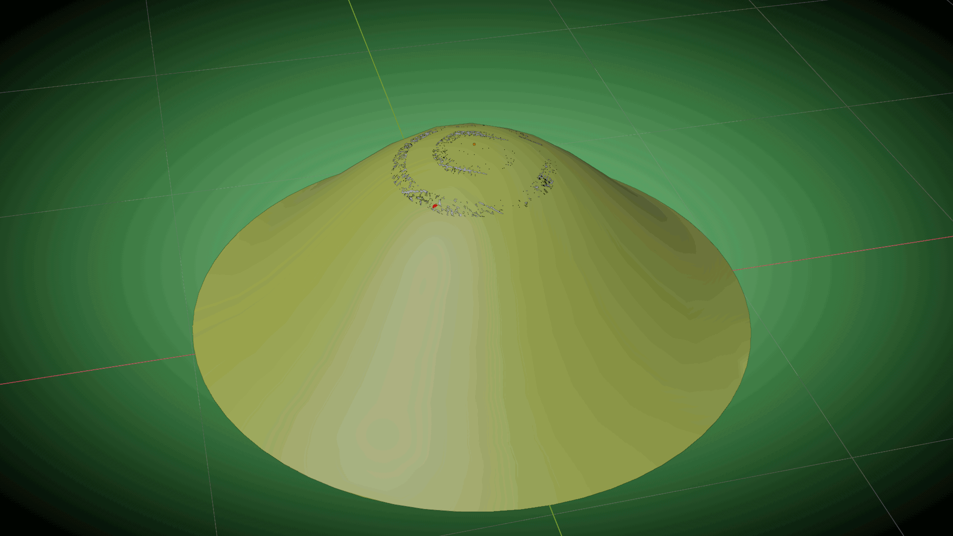

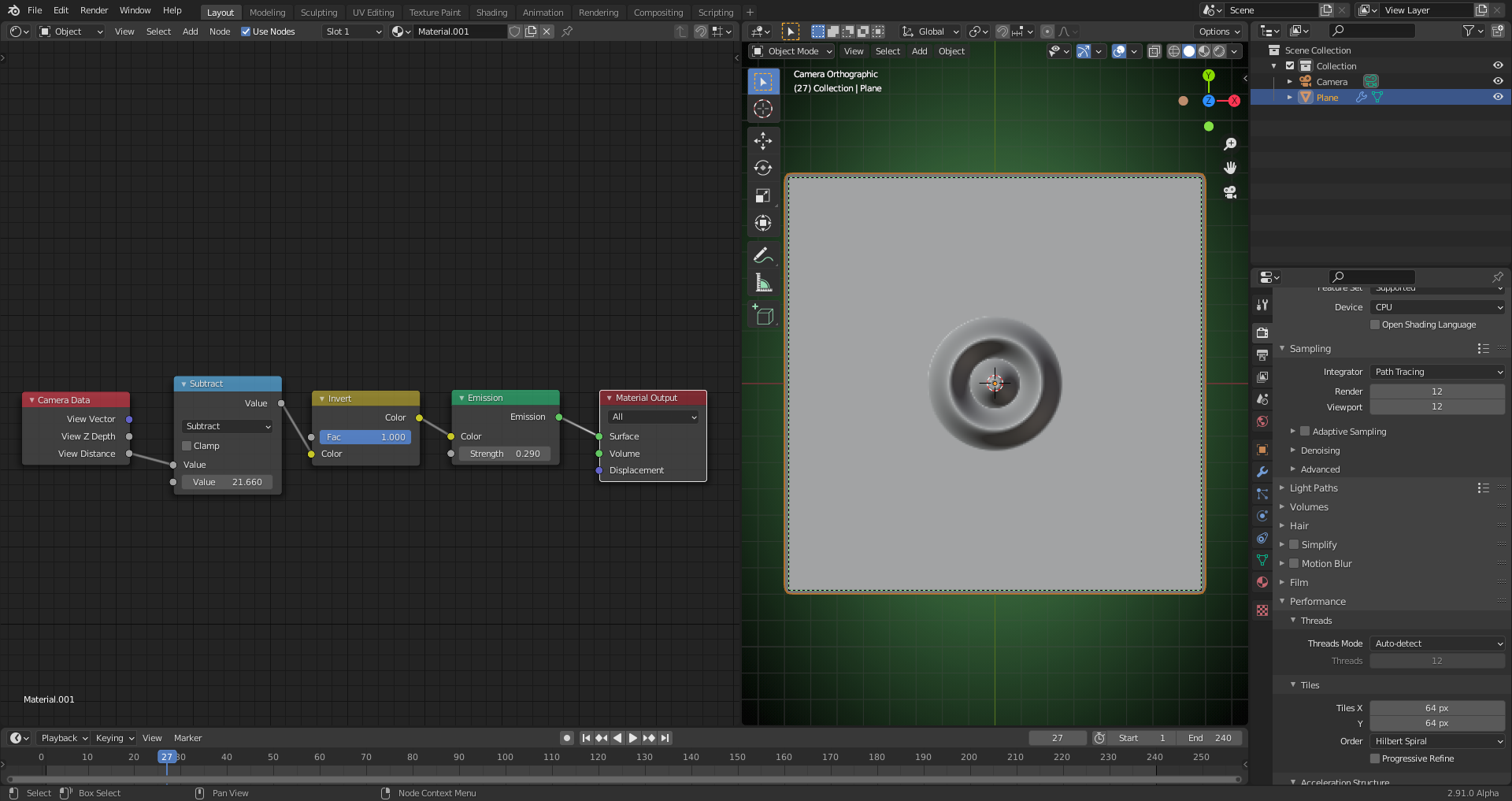

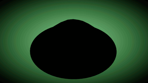

                        Just thinking about how to get a better “Terrain Shockwave” using a texture for controling the smoke or fire emitting particles:
                        This already older video from 2016 with the title “Blender 2.7* Particles From Textures (It’s Complicated)” helped me to set this up. The “Influence” of the texture has to be set to “Lifetime” in order to make it work with a “Movie Texture”. The only drawback is that you have to set the number of particles much higher than the number of particles that are displayed in the end. The “Wave Texture” was created by rendering a plane with “Wave Modifier” and “Emission Shader” in “Orthographic View” and using “View Distance” (“View Z Depth” would work, too) from the “Camera Data Node” in combination with a “Math Node” (set to “Subtract”) and an “Invert Node” as input for the “Emission Shader’s” “Color Input Socket”:

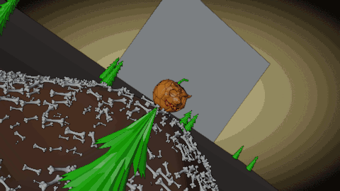

                          Another technique using “Shrinkwrapped Face Loops”, “Animated Shapekeys” and the “Push Transformation”:
