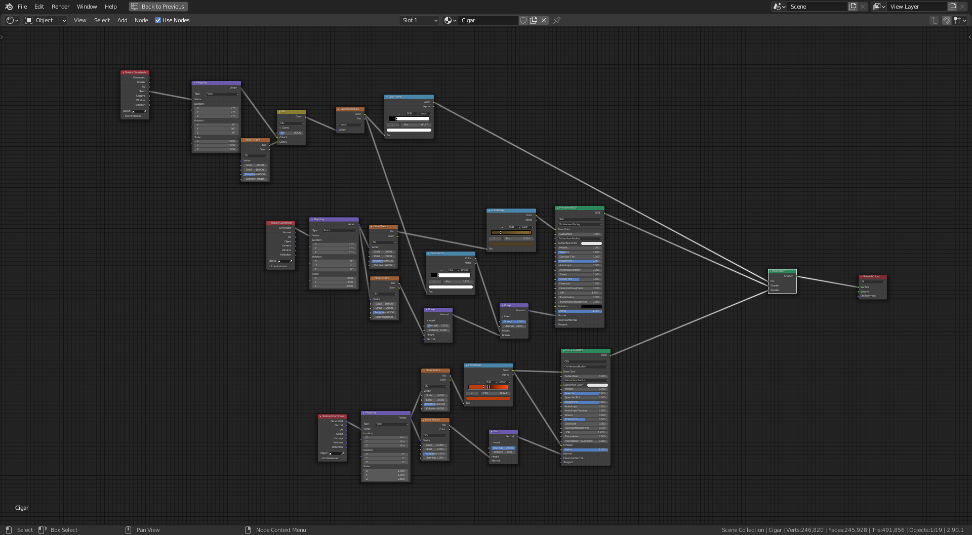

                      I was pleased with the cigar, a simple shape but the node setup just came together, this would normally take me a good couple of hours fiddling around and I’m still not 100%, but I must be improving, 15 minutes and I was happy.
                      Probably not the most efficient setup but it works.
                      #60727
                        Looks okay to me, apart from one tiny thing; can you actually see the difference between a Detail size of 16 and a Detail size of 2 or 3 in this set-up? (Top left Noise Texture!), especially since you mix it in at only about 20%…
                        Just asking, because usually the difference between a Detail of 2 or 3 and of 16 is hardly noticeable, but  16 is a LOT more computational expensive…(Detail is the most expesive setting in the Noise Texture!)
                        People do this a lot: just sliding the Detail up to max…’more is better’…Well, I’ve got an old computer, so I have to be careful 😉
                        If it works here for you that’s great, just be aware of this, in case you get more complex node set-ups 😉
                        #60728
                        Adrian Bellworthy
                          Your right @spikeyxxx , when I added the noise texture, 2 was not nearly enough so I ramped it right up to 16. I just tested it and got it down to 5 before it had a noticeable difference from 16.
                          This is one of those tricks learnt by watching @theluthier , a noise texture to influence the vector. Never needed to use it before, glad I was paying attention in class.
                          #60729
                            Yeah, that’s indeed a brilliant trick!
