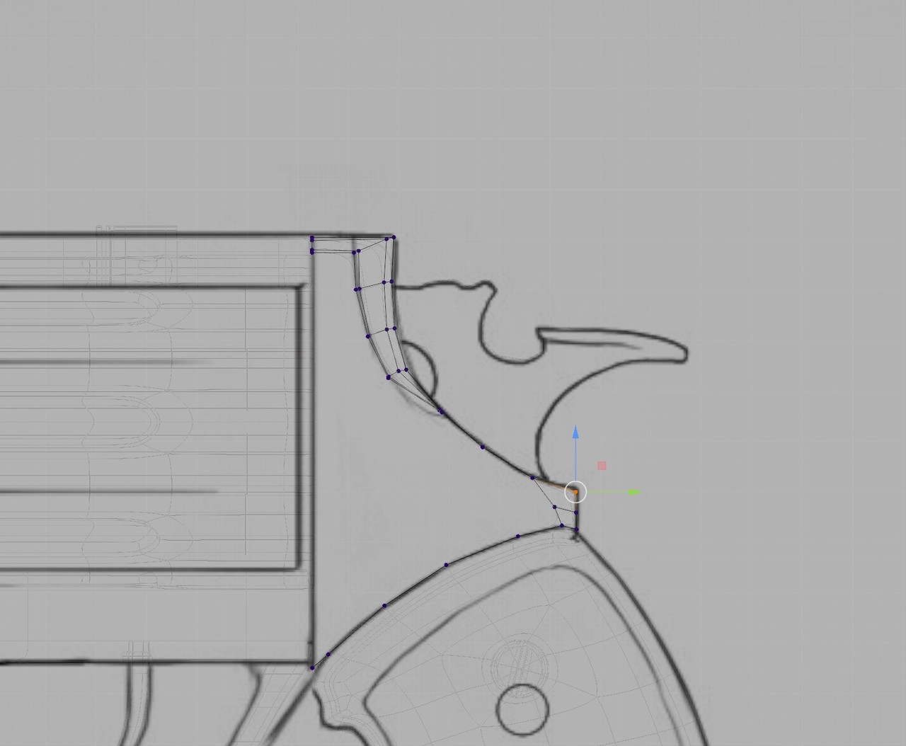

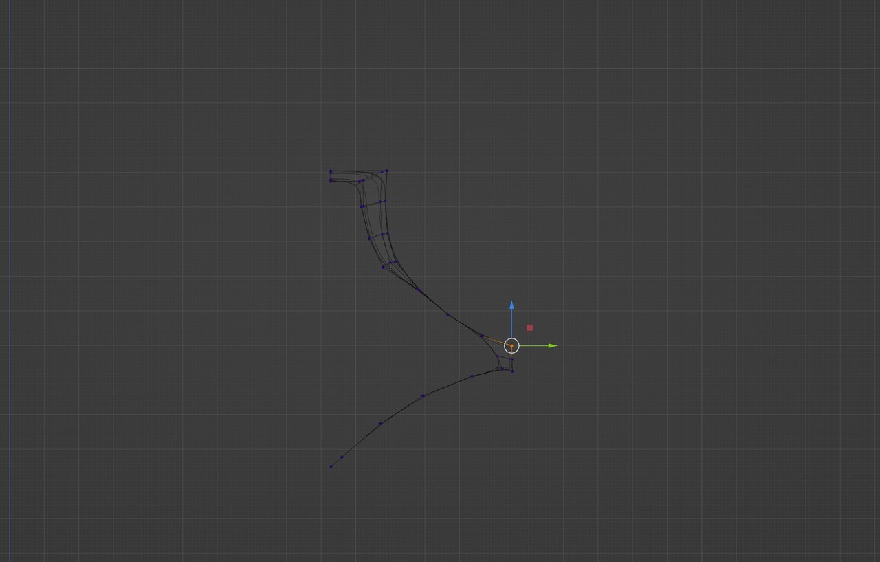

      Is there a way to be able to see the image with the blueprint in Local View – ortographic view too? (when I tap slash). I’m working separately on different pieces and the moment I hit slash to enter local view, the image disappears and I’m not able to work according to the model.
      Global view

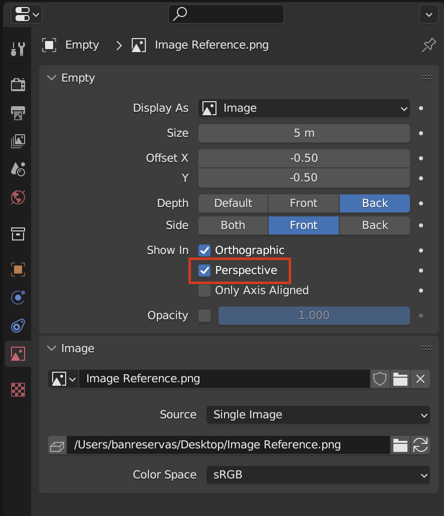

        You can add the image as a reference in the scene itself, so you can get both objects into local view:
        #77851
          And toggle On perspective if you don’t have it on:
          #77852
